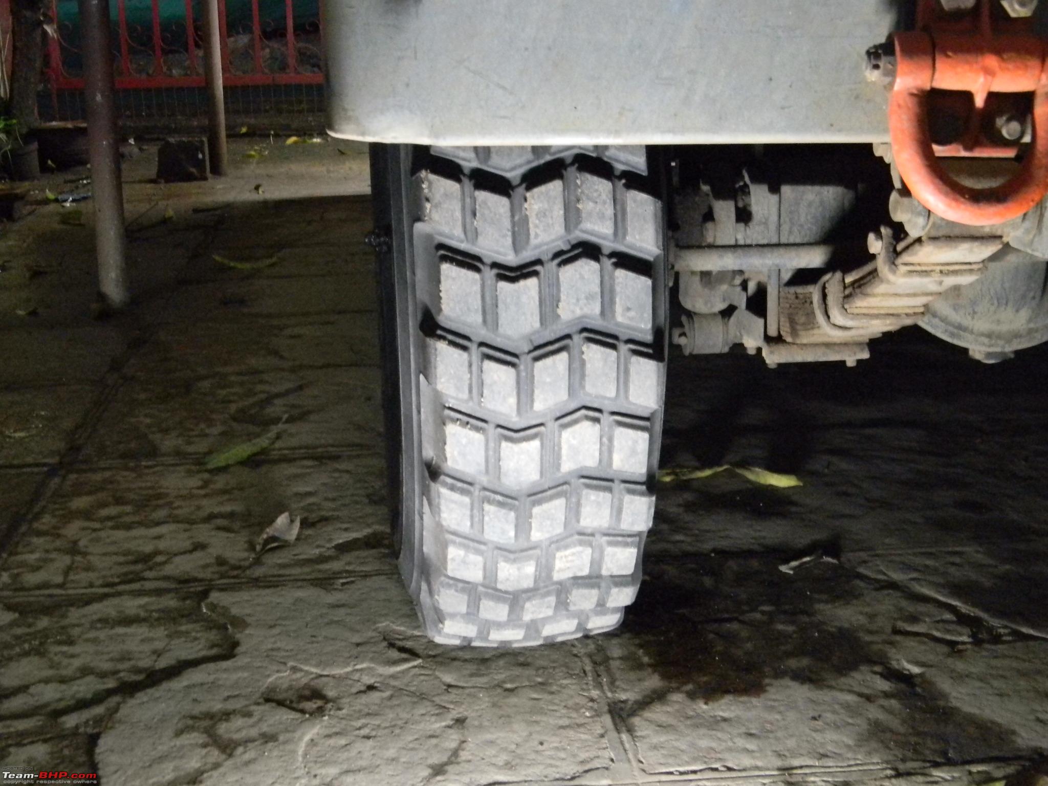

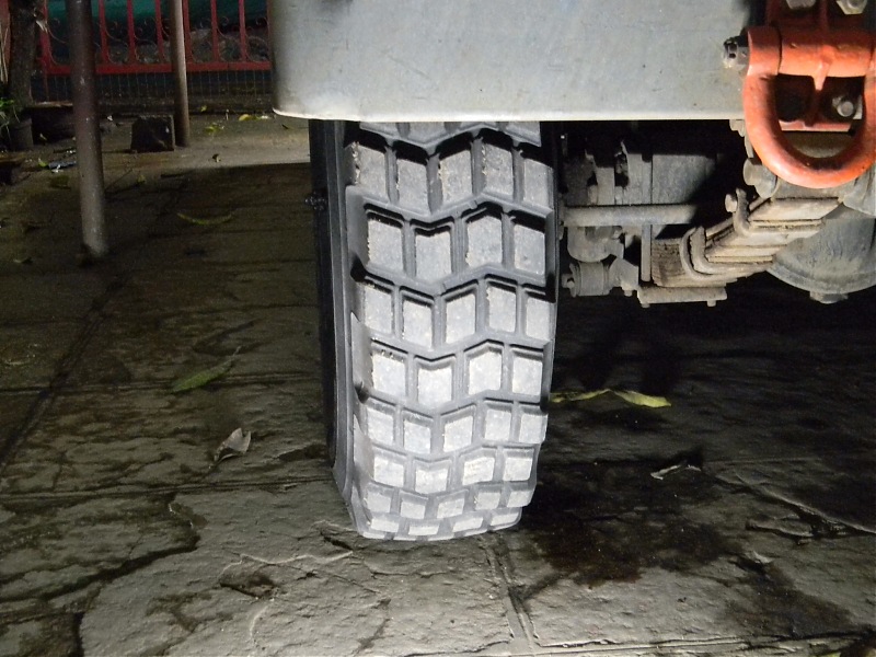

these are my ATF Sand/Highway tyres.
bought at 4.5K for a Tyre+tube.
you can see the three depths of the tyre tread.
have tested them only for 150Kms on road , so cant tell any thing for now.
