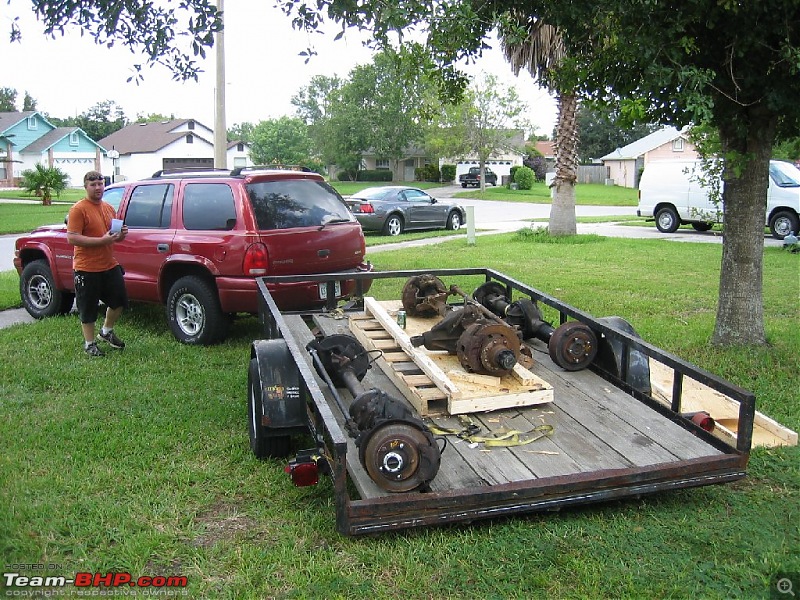

....I often have to drive hundreds Kms to reach off-road venues. How did you deal with the on-road handling of your CL340?
A solution (may be expensive/tough -- but a solution nevertheless).
Get one of this trailer attached to your GV to lug your 340 on-road to reach the OTR spot. This way you will have best of the both worlds . (and you can keep different/spare axles also to choose from for your 340 :-))
