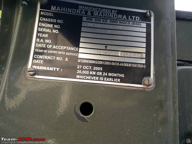

I found a 2006 4x4 MM550 NGCS BSll ex army with XD3P and a 5+1 speed gearbox, can any one help me to identify if it is a NGT or BA10

Hi,
Just look if the GB is cast iron, if so, its NGT520. If its Aluminium, then its BA10. However, I have a feeling most vehicles came with NGT520.

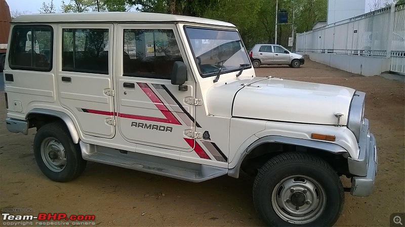

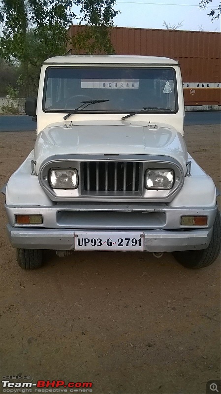

Current Photographs of the vehicle are as follows;

3. Dhanushs Sir, Maybe the picture angle was incorrect but this a wide track, Armada with a Box section NGCS Chassis, with wider spring leaves. We have had around 4 vehicles with XDP 4.90 since 90's however the highway cruising have been a big issue as XDP becomes a howler after 80kmph, My question to you can I install a 5+1 GB with XDP and live with it. Air conditioner is something I can omit completely. However Power steering I would want essentially.
Hi, Sorry for wrongly judging the photos.
Well, since you already have a NGCS with wider axles, for the below requirement
