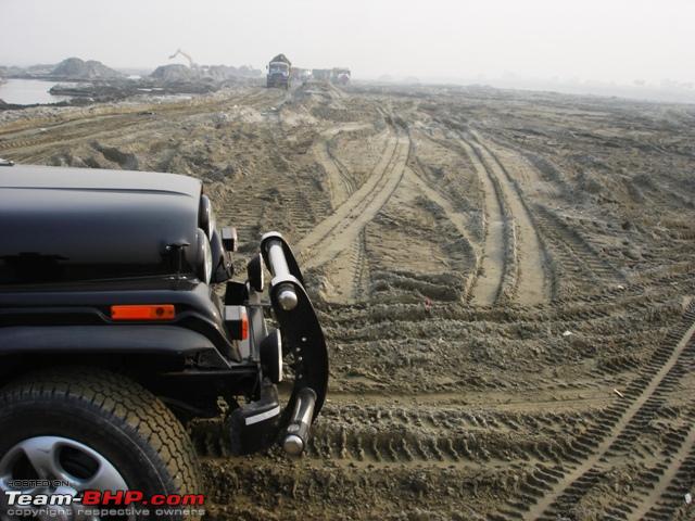

Dear Davidashish - for your viewing pleasure.
Best regards,
Behram Dhabhar

@DB Sir:
The wonderful vehicle with the wonderful pics have sad TYRES - WISH we get better FF AT tires atleast.
Have seen a few THAR CRDe perform this side of town.
NVH Great if one is coming from the MM5x0 background.
GC - cat con scraps most of the time
Good power at higher engine speeds, but unable to crawl and climb though plenty of torque available in 4L-1 or 4L-2
A FF Diff Lock or atleast LSD like the 550s would do wonders for the vehicle!
I'm debating between a CRDe and a DI still!
EDIT: Can you explain how we can adjust the front IFS Torsion bar for better articulation?

@DB Sir: The wonderful vehicle with the wonderful pics have sad TYRES - WISH we get better AT tires atleast. I'm debating between a CRDe and a DI still!
Dear Vikram - thank you for your comments. Unfortunately, CMVR will not allow the tyres you want. Changing after purchase is the only way.
CRDe or DI? Its a no brainer. My choice is of course CRDe. DI with 3.73:1? No way! It should be at least 4.88:1 for serious offroading.
By the way, you would have seen the silver Boleros of the M&M service teams (Naresh Bhosle's guys) during the Great Escapes. They are all converted from 3.73:1 to 4.88:1 axle ratio. . They are a pain to drive on the road but once off the road, they go just about anywhere!
Best regards,
Behram Dhabhar
