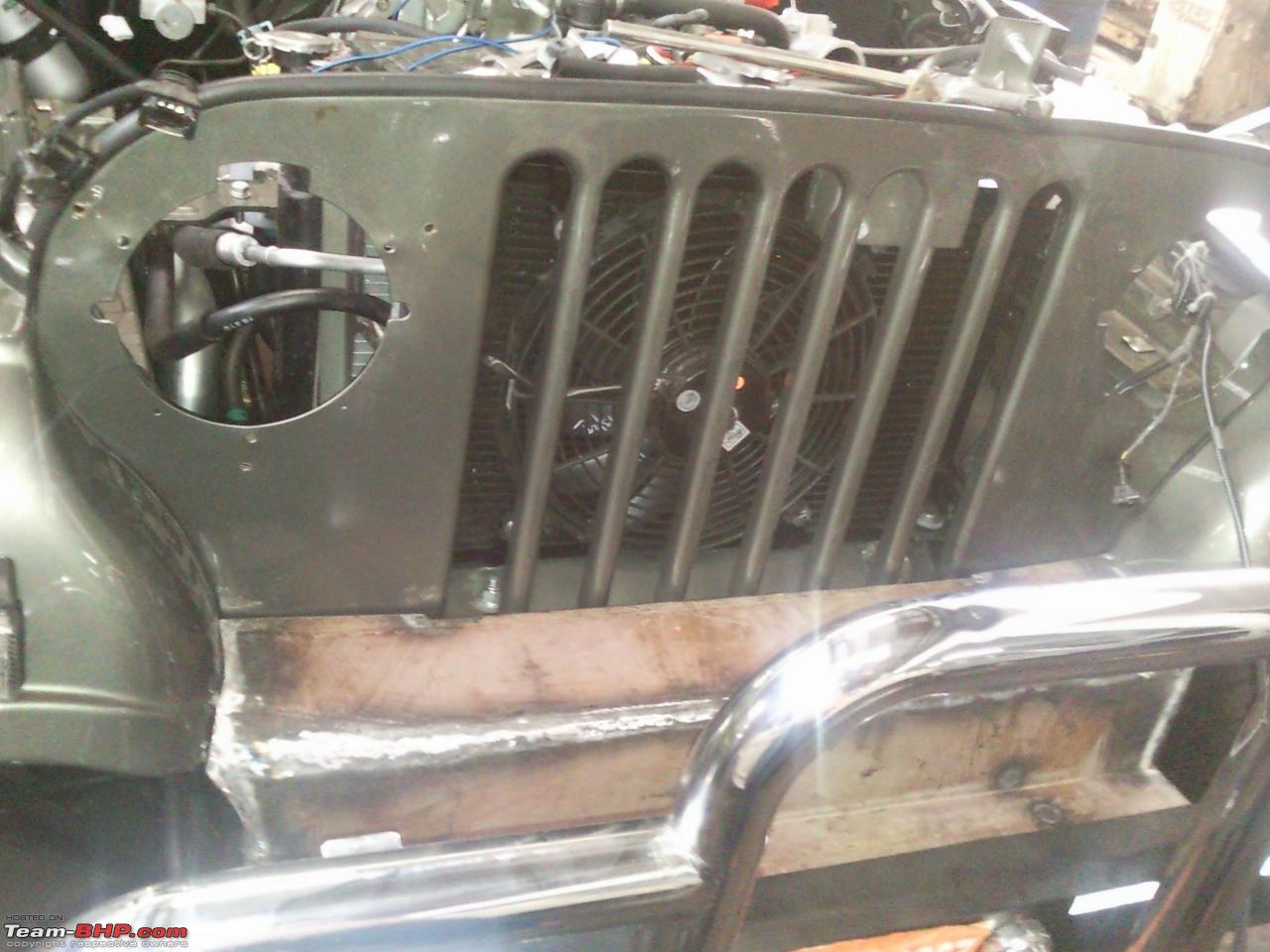

Yesterday I saw one more Thar being fitted with a/c and the intercooler being relocated at MASS. The reason being given is that there is not enough space for the fitment of intercooler; after the fitment of condensor and the fan. So I personally Inspected the same; I can say that what they said is true.
The people who fitted the a/c are really competent people and are having real expertise.
The condensor, compressor, evaporator is the Bolero OE ones.
In the picture you uploaded it seems that there are two smaller condensor fans fitted, is it true? The picture is not clear. But the Bolero OE condensor comes with only one fan.
I am here by uploading pictures of the Thar on which a/c is being fitted. You can see the enclosure for the intercooler, though the grill is yet to be made.

That white plastic bottle [3rd pic] will melt within no time - with the heat of the compressor
