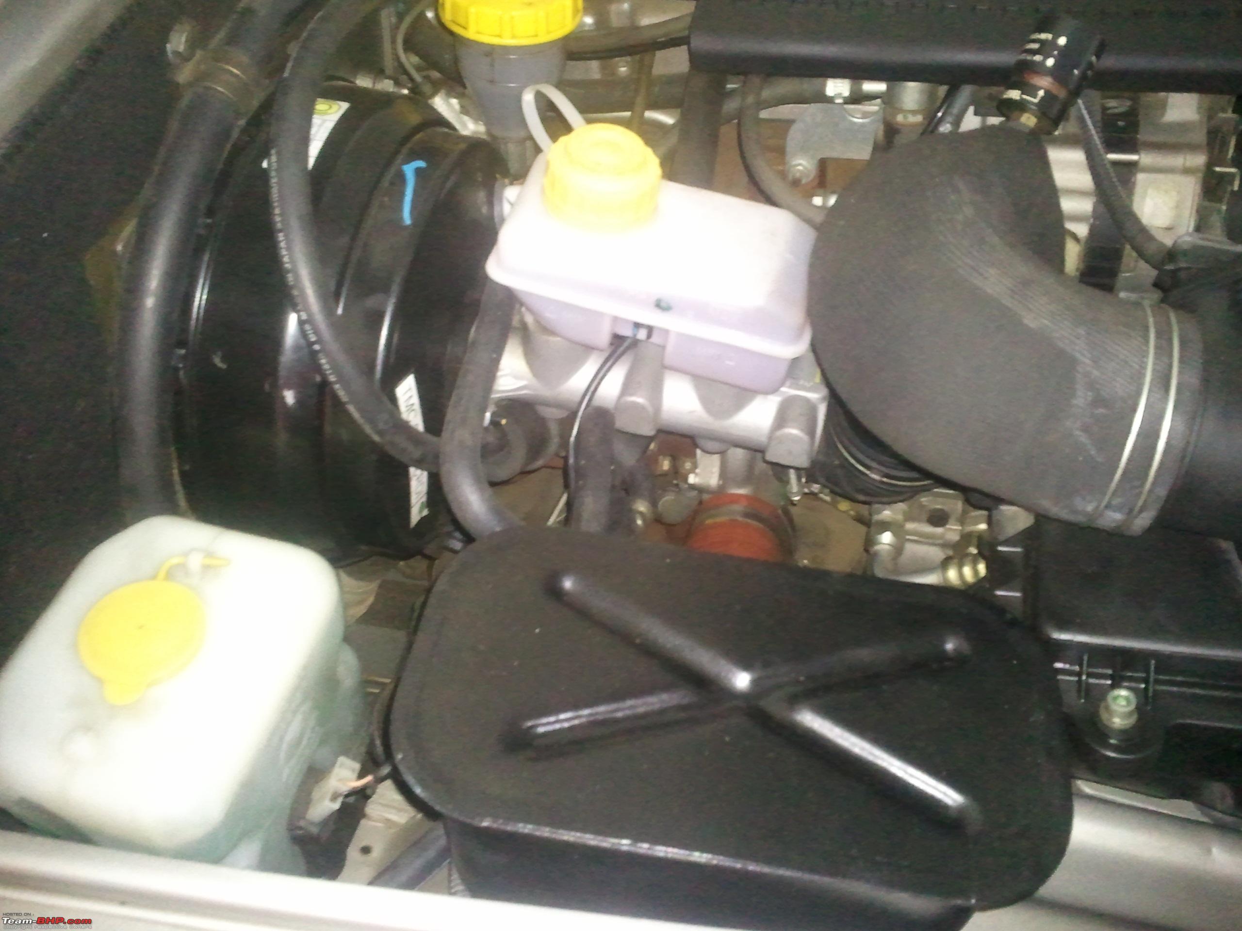

Tandem booster picture,Mhawk accumulator and Earlier accumulator removal pics attached below.
Used DOT 3 oil as recommended on top of the tandem booster (scorpio crde) .
Dont have LSPV gauge to give numerical values (SST 09709-29017-01). Fixed with T&E method.

Dear Rajith - simple. The LSPV spring locating bracket mounted on the axle has a long vertical slot. Please give the dimension of the height of the center of the spring mounting pivot from the bottom of the bracket, as you have changed this location. Dealers can then make and end gage and use for other customers' vehicles. Clean air hose is rubbing the master cylinder / reservoir. Need to add an absorber material in between to prevent NVH (noise vibration harshness) path. Alternatively, you can move the air cleaner 25mm in front by using distance spacers in X axis, but do this only as a last resort. Use hose separators to keep NVH path out of this area.

sir,
Noted, By this way i can easily get the LSPV values measured.
My clean hoses are not rubbing/loading the reservoir tank,its just a illusion in the picture. Theres a gap of a middle finger to pass thru.
No hoses are rubbing any where.

Please measure and keep it as reference, this will come in handy when you have to set the LSPV after some repairs, also helps with repeatability.
Without the correct value, the brake cut off pressure will not be regulated properly. Wheels can lock early or late, a correct value ensures the optimum setting.
