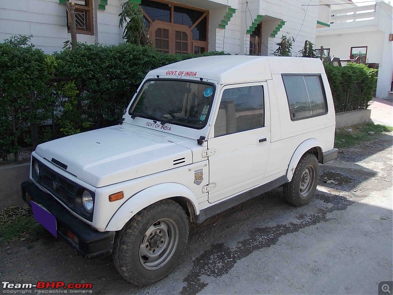

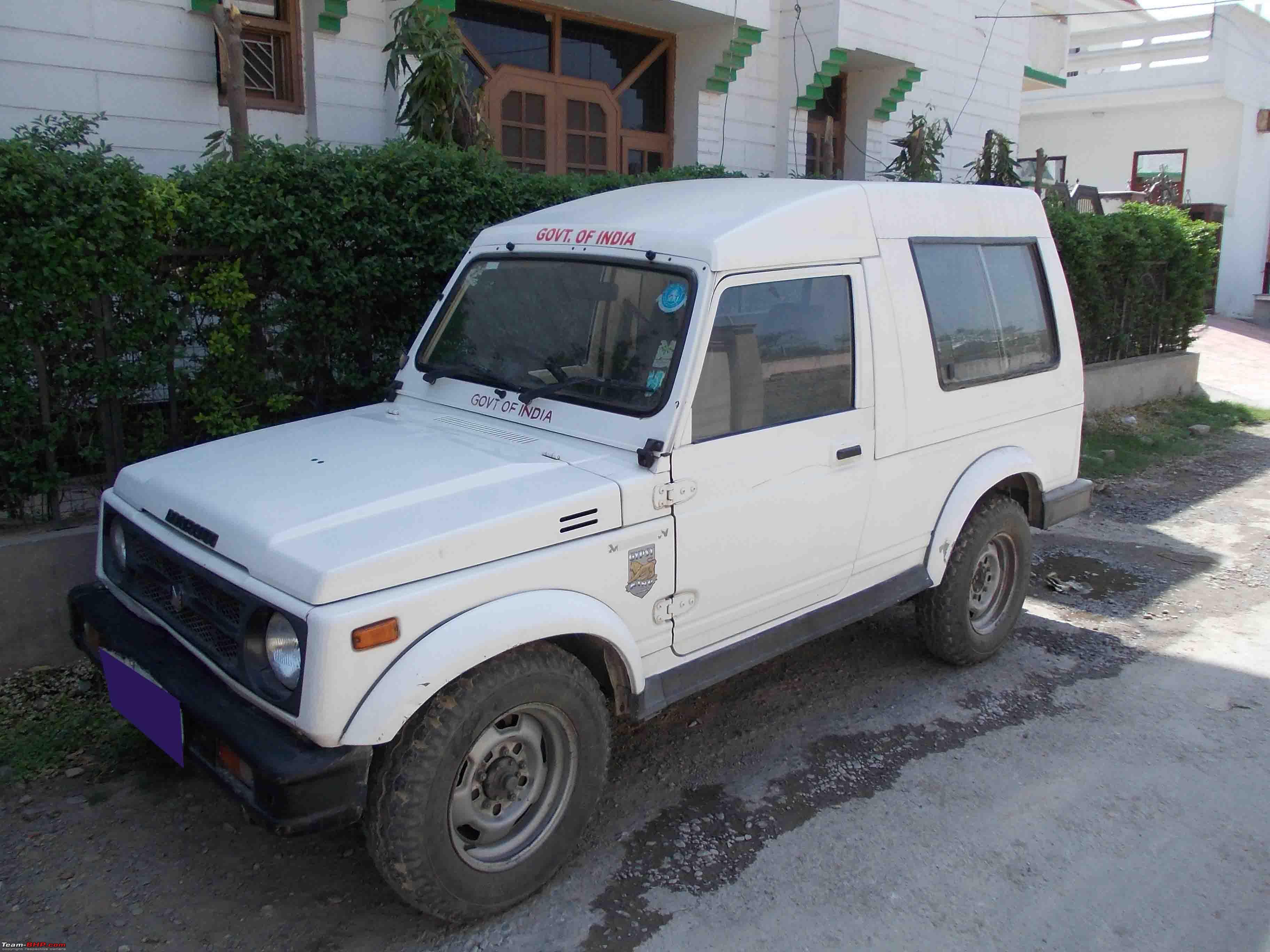

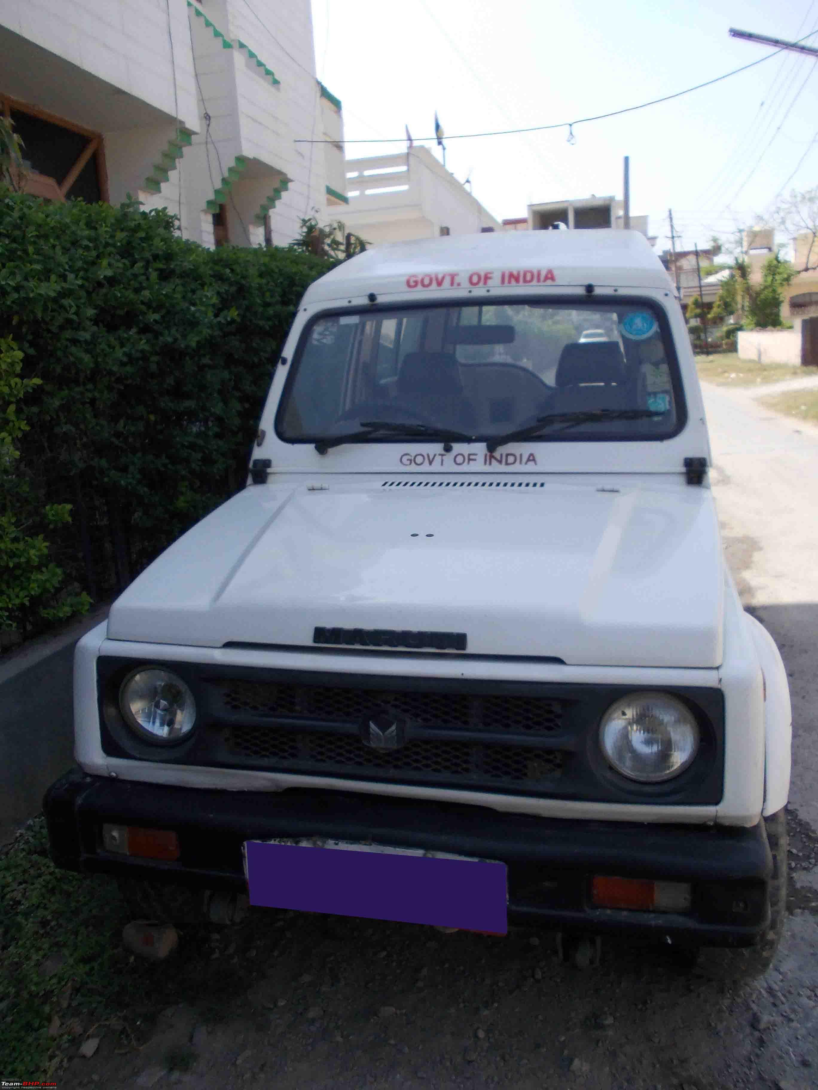

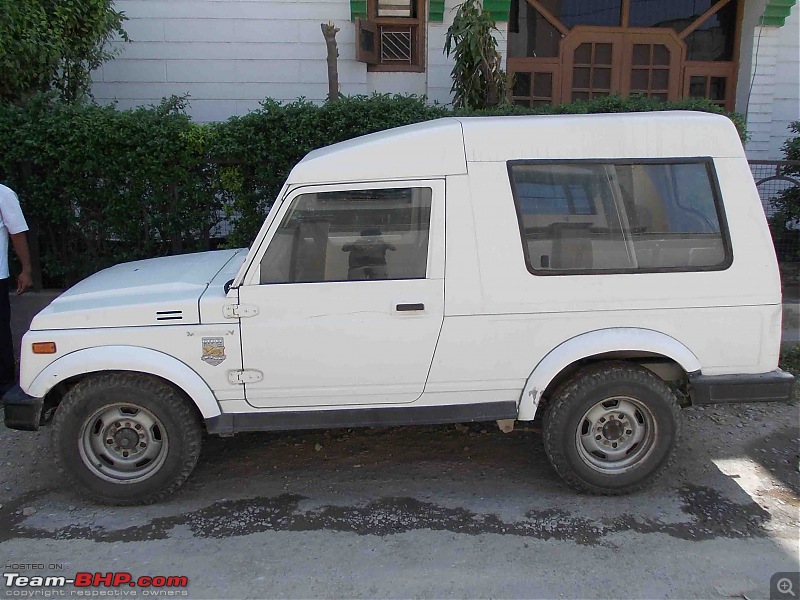

I had always wanted a Gypsy. A MPFI Gypsy King to be precise. But as life is you never get what you want. Was stuck with other things and the itch got subdued somewhat over the last few years. Recently got to know of a fine specimen available.
On a Sunday morning went with a friend and checked the vehicle. Boy, it was clean as a whistle. Best 12 yr old vehicle I had seen ever. Dint think twice and came back next week with the moolah after arranging the finances and here I was a proud owner of a excellent MPFI GYPSY KING with HT. Just as I always wanted .
Will let the pics do the talking now. I am a complete noob to Gypsy. Any and every comment is welcome.

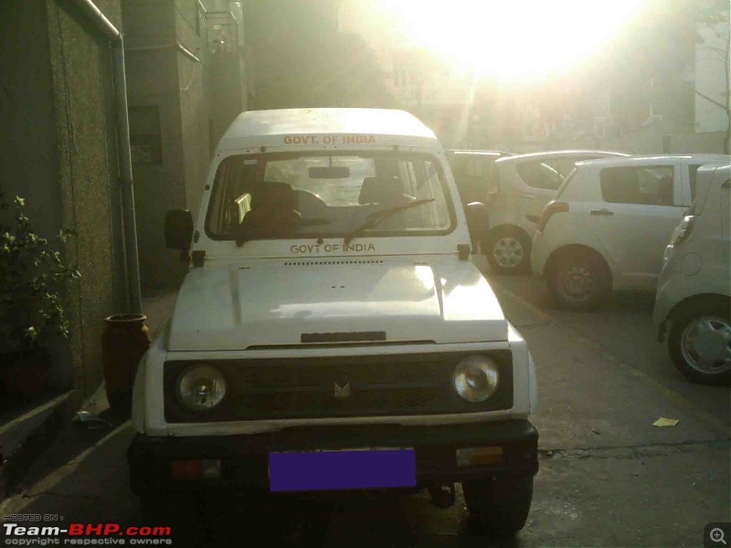

Pics of vehicle after all the below job has been done. Needs a good scrub, rubbing and polishing to bring her back to its glory.
Interesting anecdotes
  • It has run only 53000 KMS
  • Radiator was opened for the first time
  • Leaf spring were opened for the first time
  • All engine bolts are intact. Not even one bolt has a mark of spanner or anything
