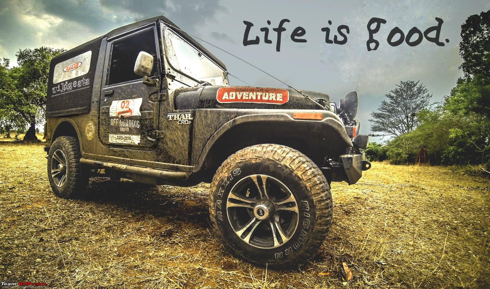

A rather mixed update to my thread. Earlier this year I had to make a difficult decision to let go of my prized possession.
Parting comments:
- I actually changed my mind a couple of times before I finally let go! I still miss the jeep, had some lovely moments with it and made some awesome friends.
- We had our journey of ups and downs between the jeep, Mahindra and me. But somehow it all got managed and there were no severe setbacks.
- In a little over 3 years, it had only done about 30k kms. Nothing as compared to my other cars. But then this wasn't really a highway runner for me either.
- Thankfully I never kept a track of how much money I spent on it, so it was easy to arrive at the final settlement and make peace with it
- In all the OTR events I've attended, the Thar performed flawlessly and I've never had to worry about anything. It did pretty much what every other jeep could do and more!

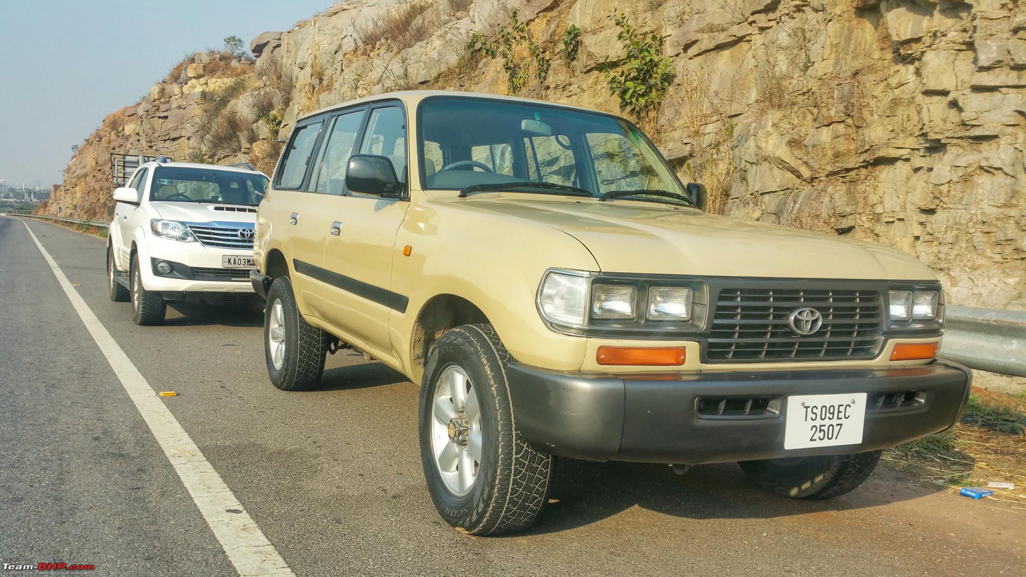

There's a bit of a sad feeling when I think about it now, but the silver lining is that it made way to another monster that's parked in my garage now. The Land Cruiser 80 series - it was like a dream come true and I just couldn't have missed the opportunity. Right now it's in hibernation because of my travel etc, but it soon going to be a monster in the making, watch out for my next thread!
