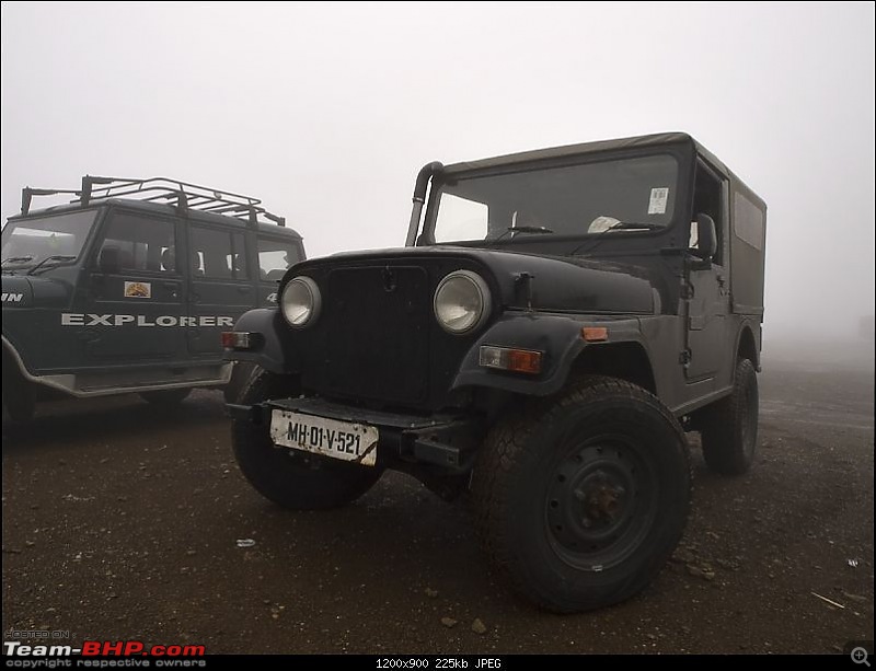

Dear Rajith - it is not release bearing noise, it is something else. The bumper that I want in Thar is as in the photograph. You will have to cut the rivets off an old CJ3B / CJ500D / MM540 (old, non-NGCS) to remove it and then weld it on the Thar chassis and paint it in shining black color. As this part is as per the original JEEP bumper drawing, the vehicle will look exactly like a classic JEEP (killer!). Do it, nobody's done it so far!
You can see the original JEEP design outside rear view mirror also in the same photograph. Please scout around, in some Chor Bazaar if you find the mounting, buy it and use the TATA 407 mirror, your vehicle will look fabulous! You can do it on one vehicle yaar, you don't have the "constraints"!
