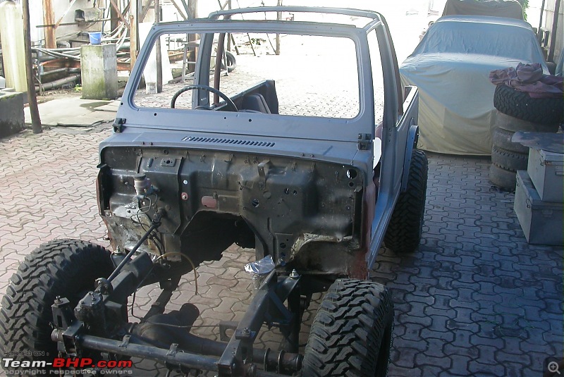

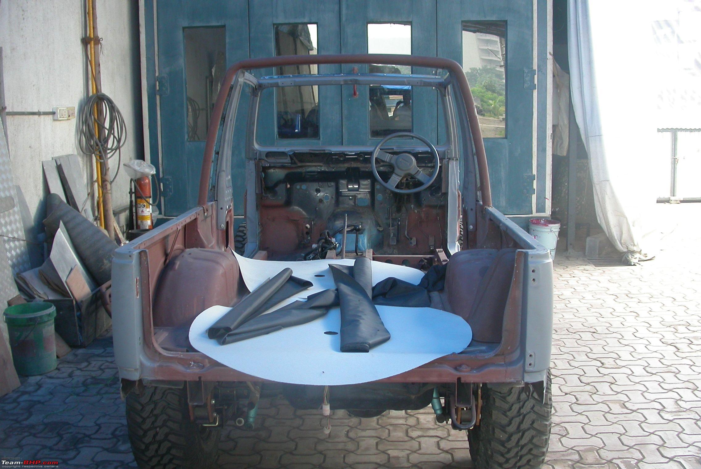

work on in super fast mode
long weekend has taken its toll
the entire car is ready in terms of body work mins the paint
but as you can see the engine bay is still empty
just this and she will be ready in no time

Originally Posted by xtreme power View Post
Attachment 198514

Allan, I noticed that the front & the rear leafs are not stock and looks like quite a few extra leafs have been added. How many extra each in front & back? Also what is the size of the shackles -- hole to hole?

Mounting the RIM ulta? isnt it risky?

Wow!
Thats negative-offset rims for free!
nitrous is offline   Reply With Quote
Excellent spotting there. It was just not easy to spot that, even i was wondering from where did he source these rims.
Not ulta jaggu, i think he's gone more radical than just a simple ulta setup. He must've re-offsetted the rims, or widened the stock rims.
Nice work Xtreme Power Will be watching this thread. Exciting part is yet to come, the Engine
