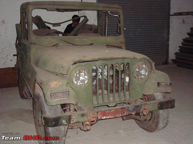

Jeep MM 540: INR 45,000.00
Nissan TD 25 Engine and GB: INR 68,000.00
MM Scorpio Pr. Steering Box: INR 15,000.00
MM Loadking Power Brake: INR 3,000.00
New Brake Pedals from the floor type: INR 3,500.00
Qualis Di Filter n Lancer Fiter cover: INR 3,300.00
Patchwork n painting: INR 30,000.00
Lights n Switches n Wiring:INR 11,500.00
Seatsn Upholstery : INR 8,000.00
Alloys:INR 35,000.00
Labour( Heavily Discounted): INR 18,000.00
From this to this.

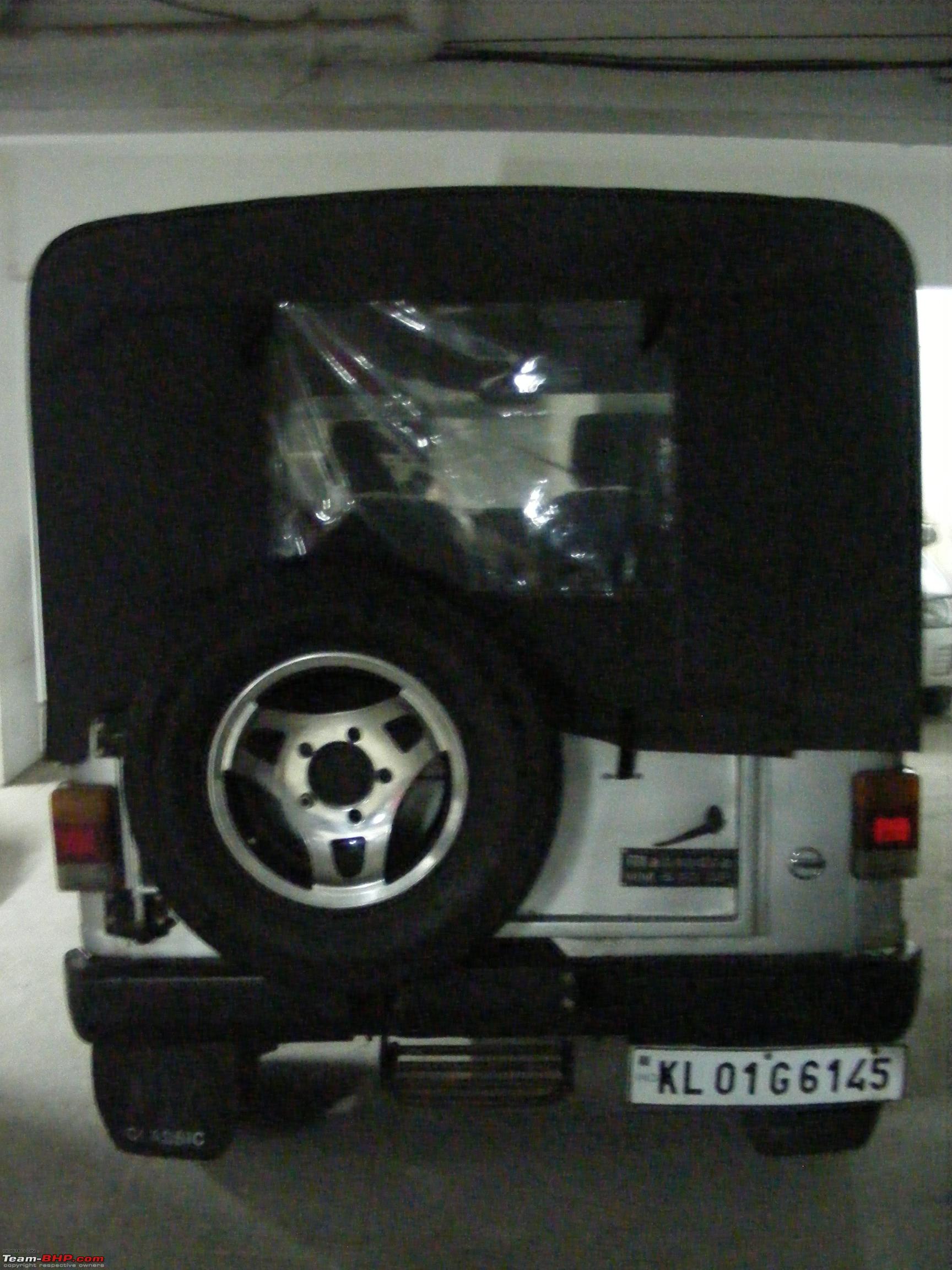

Hey Guys,
I have spent 60K for the scrap Jeep Look at the first 2 pics.
25 K for Body and paint job.
None for Toyota Innova front 2 seats and Extreme double foldable seats - "Jugaad".
20K for Sandgrips - Kind Courtesy Harjeev
Mechanical Job and Engine overhaul - 35 K
Small little tings aith some accessories - 20 K
So In all I have spent about 1.6 lks on the vehicle though its a roug cut summary. The current pics (still 2 months old) attached.
I stopped the work on it due to my wedding (I got married on 1st Nov). Now I will start the work again. As it is said the work on Jeep never stops.
Still to do
Registration - 30K
Some more tinkering and fitting some more accesories - 25 K
And counting so on....

Ricky where is the cost factor.
one of the best images of before and after.

Hi Tarkeesh,
What a transformation man, from crap to a beauty! 1.6 lakhs till now sounds good. Thats the advantage of picking up a jeep dirt cheap.
BTW congratulations on your marriage!:-))...hope she too likes your jeep:-)
