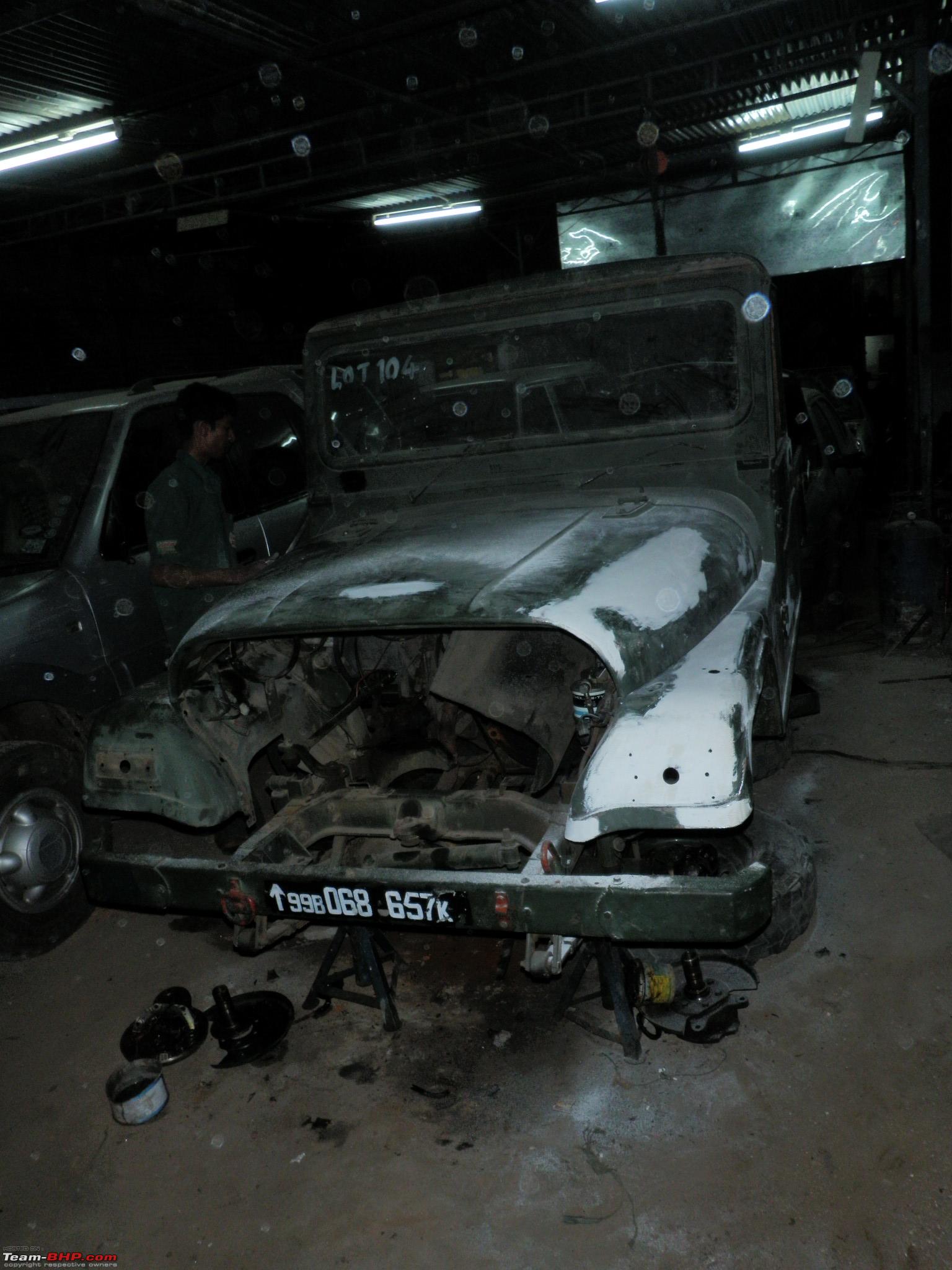

Latest Update
The engine has been completely dismantled and sent to lathe for re boring.
Also replacing 4 pistons, piston rings, Con rod bearings, Main bearing and Cam rod. Head also sent for pressure testing.
Fuel pump given for servicing along with fuel nozzles.
Brakes removed. All brake pads front and back to be replaced. Brake discs to be sent to lathe. Rear drums also will be sent to lathe. Rear brake pads will be replaced with one over size. King pin bearings and wheel bearings will be replaced. Front RH King pin housing will be replaced.
Replacing clutch plate and pressure plate.
Body has been stripped of all accessories. Dents removal and body putty application in progress.
Some of you wanted to know about the costings. Like I had told earlier as everything was handled by Viji and Roshan i dont have the breakup of the jeep cost, transport, taxes, bribes etc etc.. but in total i paid 1.7 lakh to Viji for the Jeep.
Here are some of the WIP pics.
Nishanth

Hi Nishanth,
Congrats on your Jeep and All the very best for restoration...
Hey, whats this on your dash board near special swith? I have circled it.

@Tarkesh
I think the button should either be the starter but most likely I think that it can be the horn too!!! But on other thoughts it may be anything fogs, cabin light switch
It may also be a trip switch for high and low(head light), form your picture i find the head light switch is missing below the steering. kindly forgive me if i am wrong!
You mean the right hand side combination switch right? No its not missing. In the pic just covered up by the steering wheel.
