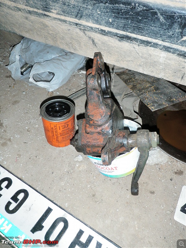

Default WIP Updateas on 17 Jan 2010
Hi Guys
Update as on 17th jan 2010
1 : Brakes
-Front Disc brakes and Rear drum brakes back from lathe after machining.
-Overhauled and fitted back both brakes with new pads and liners.
- New cylinder for the rear drum brakes.
-Front brake caliper washer set replaced.
-FWH opened up lock washer and grease changed and overhauled.
2 : Steering / Suspension
-Tie rod ends changed to new ones
- Torsion bar bushes replaced with new ones
-King pin bearings changed.
- Wheel bearings changed
-Front RH King Pin housing replaced.
-Steering unit removed for changing oil seal and replacing the oil, Work still in progress.Will be completed on Monday.
-All wheels fitted back
-Rear LSD checked and found satisfactory.
3 : Engine
-Engine back from the lathe .
-Engine liners/sleeve replaced.
-Reboring and polishing done.
-Main berings and con rod bearings replaced.
-Cam shaft complete replaced with new one.
-Crank shaft grinding and crank shaft oil seal Knurling redone.
-All 4 pistons and rings changed to new.
-Cam Tappet valve rocker 8 nos changed.
-Head pressure tested.
-Head surfacing, guide and valve cutting, checking, servicing and assemble done.
-The engine block from lathe serviced and cleaned with HP water.
4 : Body work
-Body stripped of all fittings and accssories.
-Found cracks on the body tub mainly around the rear bench and driver seat fittings.
-All cracks welded back
-Windscreen removed.The glass cracked while removing so now got to change the windshield glass.
-Doors / bonnet / fenders / front grill / frontand rear bumper accssories removed.
Some pics of the WIP:

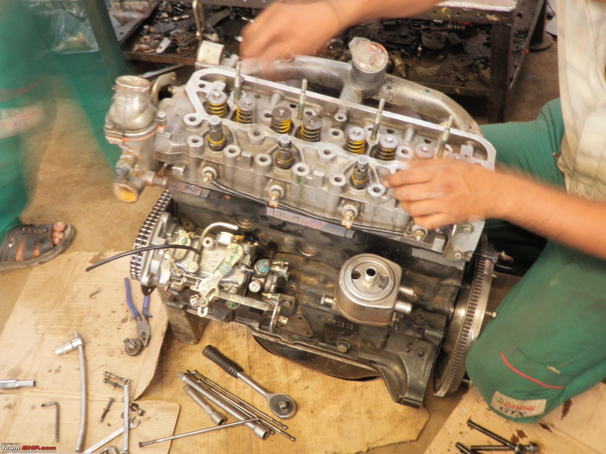

Default Update 22 Jan 2010 - engine assembly
As told before engine rebuild is complete. It is not yet fitted back on the chasis as the painting work is in progress.
These are the work done / items changed in the Engine. and the clutch
1. Glow plugs
2. Fuel pump re-serviced.
3. Fuel line High pressure diesel wash.
4. Fuel nozzle had become weak so all fuel nozzle replaced.
5. Cam / Complete cam shaft replaced.
6. Sleeves replaced and reboring done.
7. Pistons replaced
8. Piston rings replaced.
9. Con rod bearings repaced.
10. Main bearings replaced.
11. Main bearing thrust washer replaced.
12. Oil pump replaced.
13. oil filter replaced
14.Cam tappet all 8 nos replaced. (Had to run around quite a lot to get the original replacement for this.)
15. Piston head pressure testing done.
16. clutch plate and pressure plate assembly replaced.
Here are the pics of WIP of the engine assembly..
Checking the new piston rings and the cylinder liner bore.
It's a 'Jeep' Thing!" - Army Spec MM550 - Restoration in Bangalore - PHASE 1 COMPLETE-p1180626.jpg
It's a 'Jeep' Thing!" - Army Spec MM550 - Restoration in Bangalore - PHASE 1 COMPLETE-p1180630.jpg
Inserting the new piston and the rings
It's a 'Jeep' Thing!" - Army Spec MM550 - Restoration in Bangalore - PHASE 1 COMPLETE-p1180633.jpg
Tigntning the con rod and main bearing bolts with torque spanner
It's a 'Jeep' Thing!" - Army Spec MM550 - Restoration in Bangalore - PHASE 1 COMPLETE-p1180635.jpg
removing back one piston to replace one con rod bolt
It's a 'Jeep' Thing!" - Army Spec MM550 - Restoration in Bangalore - PHASE 1 COMPLETE-p1180639.jpg
It's a 'Jeep' Thing!" - Army Spec MM550 - Restoration in Bangalore - PHASE 1 COMPLETE-p1180641.jpg
Pistons in place
It's a 'Jeep' Thing!" - Army Spec MM550 - Restoration in Bangalore - PHASE 1 COMPLETE-p1200643.jpg
Cleaning the fly wheel and oil cooler
It's a 'Jeep' Thing!" - Army Spec MM550 - Restoration in Bangalore - PHASE 1 COMPLETE-p1200644.jpg
It's a 'Jeep' Thing!" - Army Spec MM550 - Restoration in Bangalore - PHASE 1 COMPLETE-p1200649.jpg
Placing the timing belt, oil cooler and fuel pump
It's a 'Jeep' Thing!" - Army Spec MM550 - Restoration in Bangalore - PHASE 1 COMPLETE-p1200654.jpg
It's a 'Jeep' Thing!" - Army Spec MM550 - Restoration in Bangalore - PHASE 1 COMPLETE-p1200655.jpg
Placing the head
It's a 'Jeep' Thing!" - Army Spec MM550 - Restoration in Bangalore - PHASE 1 COMPLETE-p1200657.jpg
connecting the fuel lines
It's a 'Jeep' Thing!" - Army Spec MM550 - Restoration in Bangalore - PHASE 1 COMPLETE-p1200661.jpg
Placing the tappet and cover.
It's a 'Jeep' Thing!" - Army Spec MM550 - Restoration in Bangalore - PHASE 1 COMPLETE-p1200665.jpg
the complete assembled engine
It's a 'Jeep' Thing!" - Army Spec MM550 - Restoration in Bangalore - PHASE 1 COMPLETE-p1200667.jpg
Nishanth

The body work has started.
Tinkering has been finished.
Painting process has started.
WIP pics of the body work
It's a 'Jeep' Thing!" - Army Spec MM550 - Restoration in Bangalore - PHASE 1 COMPLETE-p1200646.jpg
It's a 'Jeep' Thing!" - Army Spec MM550 - Restoration in Bangalore - PHASE 1 COMPLETE-p1210674.jpg
It's a 'Jeep' Thing!" - Army Spec MM550 - Restoration in Bangalore - PHASE 1 COMPLETE-p1210675.jpg
It's a 'Jeep' Thing!" - Army Spec MM550 - Restoration in Bangalore - PHASE 1 COMPLETE-p1210677.jpg
It's a 'Jeep' Thing!" - Army Spec MM550 - Restoration in Bangalore - PHASE 1 COMPLETE-p1210678.jpg
It's a 'Jeep' Thing!" - Army Spec MM550 - Restoration in Bangalore - PHASE 1 COMPLETE-p1210683.jpg
It's a 'Jeep' Thing!" - Army Spec MM550 - Restoration in Bangalore - PHASE 1 COMPLETE-p1210684.jpg
It's a 'Jeep' Thing!" - Army Spec MM550 - Restoration in Bangalore - PHASE 1 COMPLETE-p1210686.jpg
It's a 'Jeep' Thing!" - Army Spec MM550 - Restoration in Bangalore - PHASE 1 COMPLETE-p1210687.jpg
It's a 'Jeep' Thing!" - Army Spec MM550 - Restoration in Bangalore - PHASE 1 COMPLETE-p1210689.jpg
It's a 'Jeep' Thing!" - Army Spec MM550 - Restoration in Bangalore - PHASE 1 COMPLETE-p1210690.jpg
It's a 'Jeep' Thing!" - Army Spec MM550 - Restoration in Bangalore - PHASE 1 COMPLETE-p1210691.jpg
hgnishanth is offline   Reply With Quote
