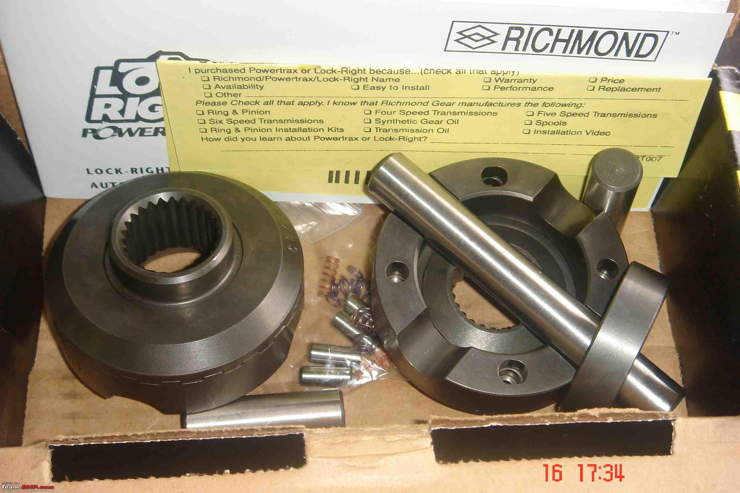

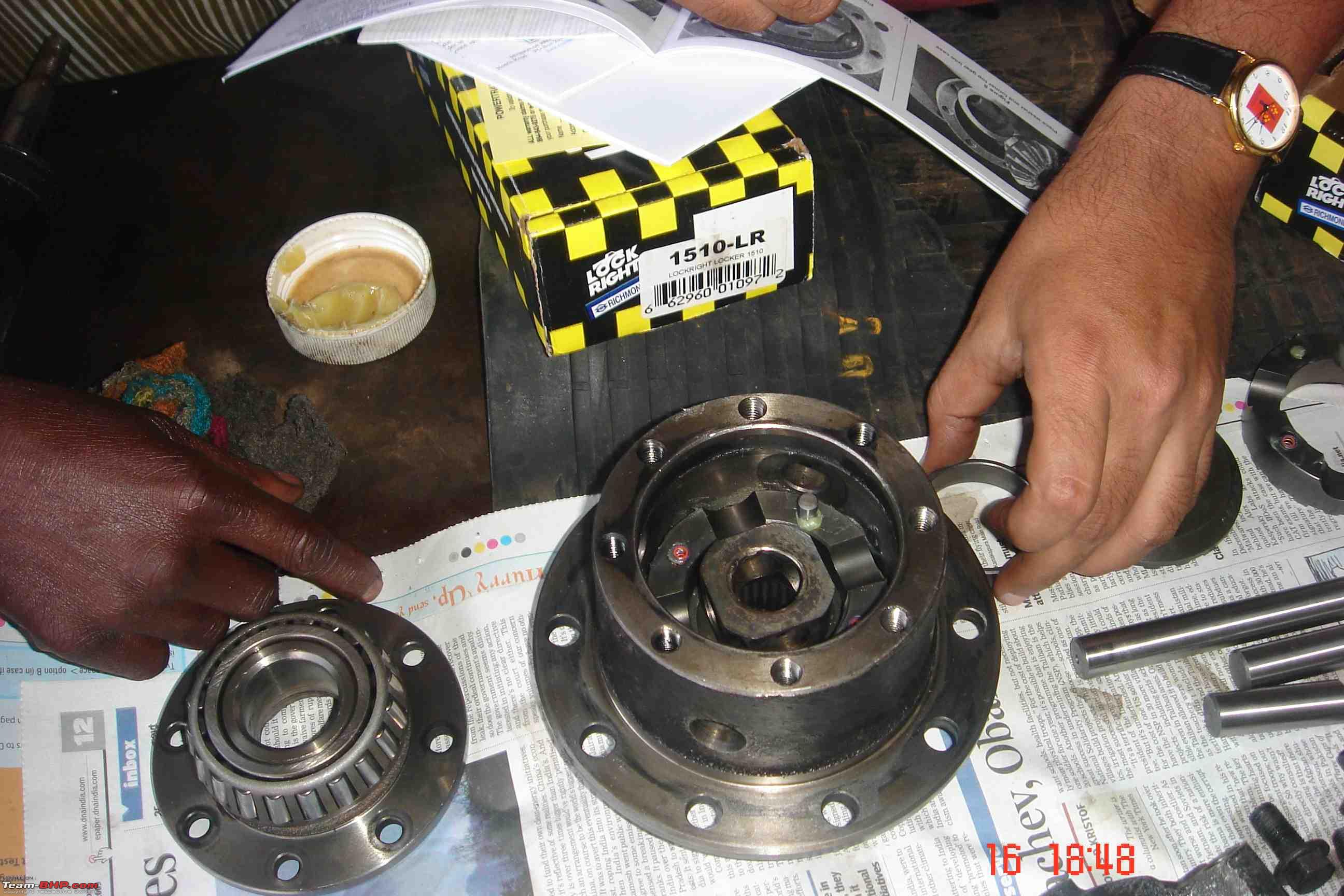

Originally Posted by bishancm View Post
Could you please elaborate more on the lockers.From my understanding, what I see from the pictures as being installed is lockright 1530 which comes with side gears.
http://www.team-bhp.com/forum/attach...ypsy-spoa3.jpg
But I also see a pack showing 1510 LR
http://www.team-bhp.com/forum/attach...psy-spoa17.jpg
Hence the Confusion. Are you using both by the way.
Bishan
The 1510 was mine and had taken it there during the install to show differences between 1530/1510.
Have put in 1530 in the rear.

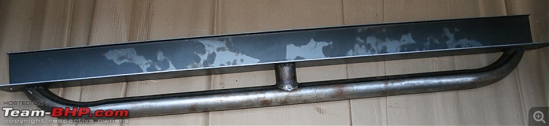

Finalized rock slider design and specs, i now using 3 mm L angle, it looks ok to me,

....Finalized rock slider design and specs, i now using 3 mm L angle, it looks ok to me,
Sir, as discussed, this couldn't be any better. Just don't forget the LED's

Whats the difference between 1510 and 1530 KS?
headers is offline   Reply With Quote
Old 19th April 2010, 16:58   #42
khan_sultan's Avatar
Join Date: Apr 2006
Posts: 4,664
Thanked: 3,466 Times
Default
1510 is without the coupler and uses stock side gears. 1530 is with coupler and stock side gears are not used. Also the shape of the 2 are different, with the locker tooth in 1510 being slanted/angular & in 1530 being 100% flat
I had procured 1510 to put it in the front axle also and had taken it along.

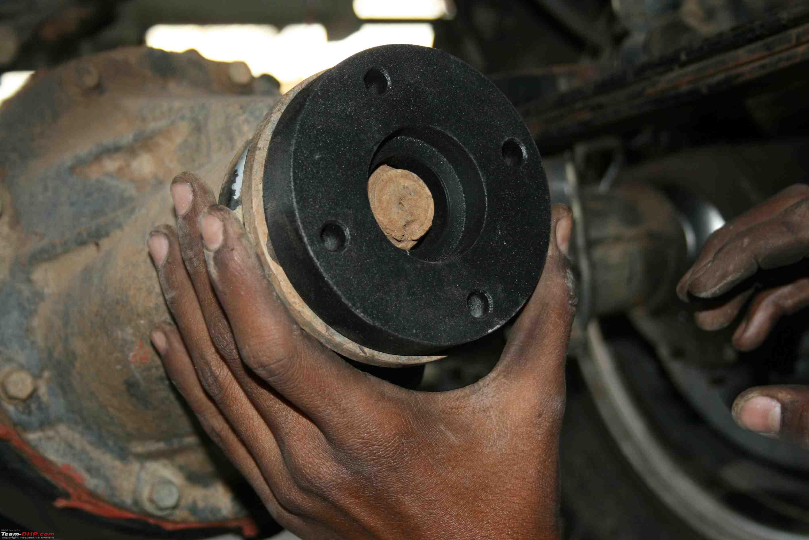

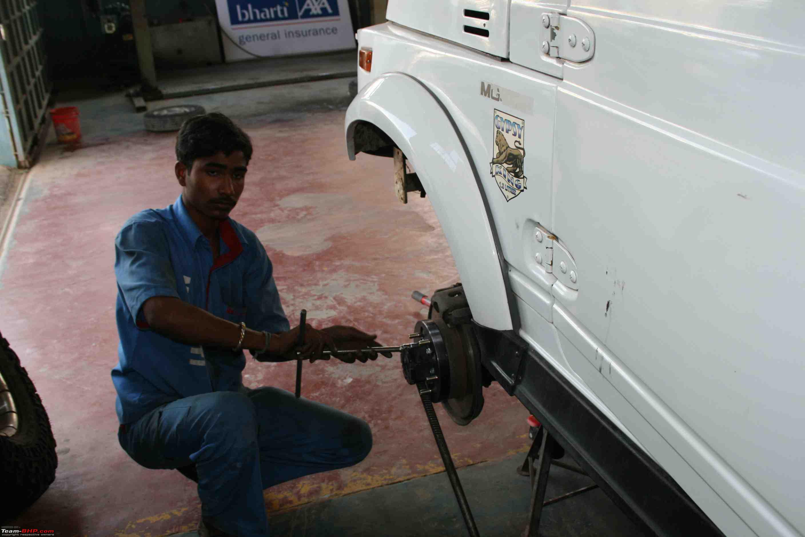

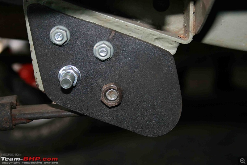

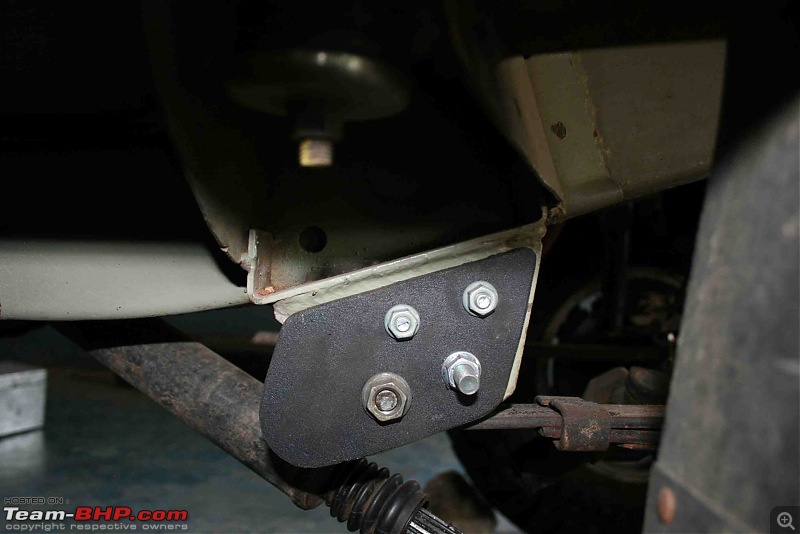

Rear up front (RUF) work completed today, i am uploading few pictures of WIP.

The Front and rear driveshaft extensions were made in Lathe or procured from outside?
Wraparound spring pads custom made or procured?
What about brake line extension?
