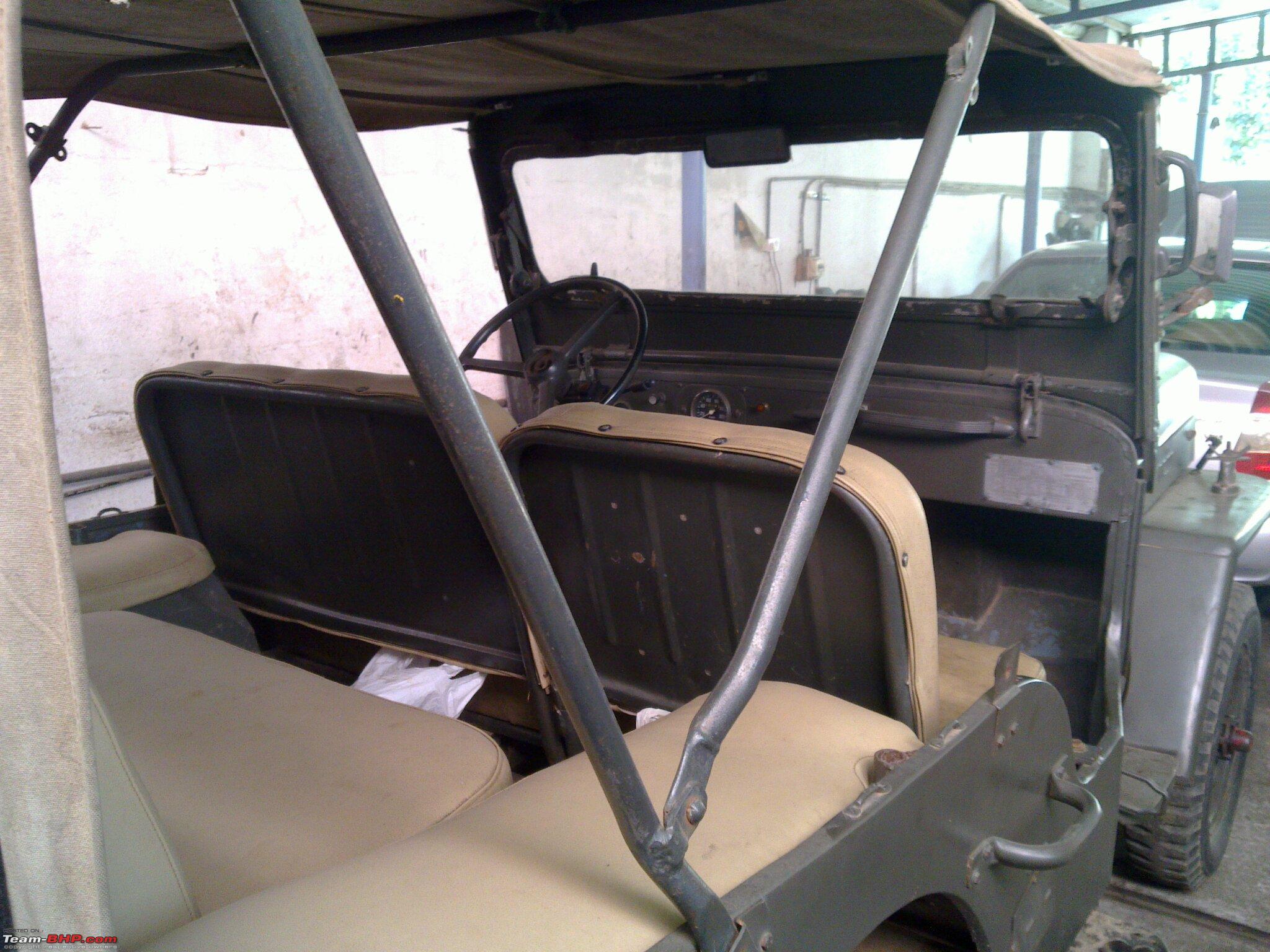

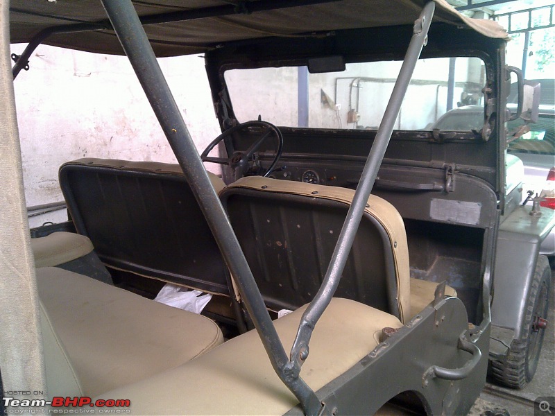

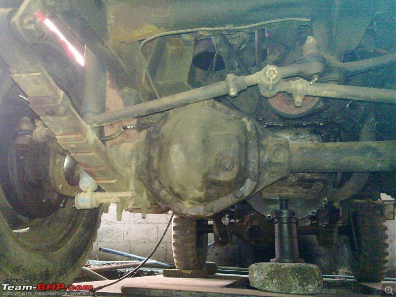

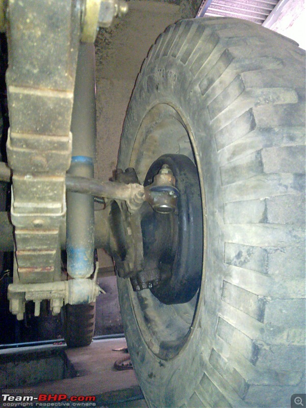

I am posting a few pics of the Jeep for now and will update the thread with the pictures of the following as suggested by my dear friend Andy.
Interiors
1. From drivers seat right into steering wheel and beyond
2. From passenger's side
3. Showing the positioning of handbrake
4. Remove driver's side foot mat and show brake inspection lid
5. Foot operated dip/dim switch
6. Tub area from 4 sides

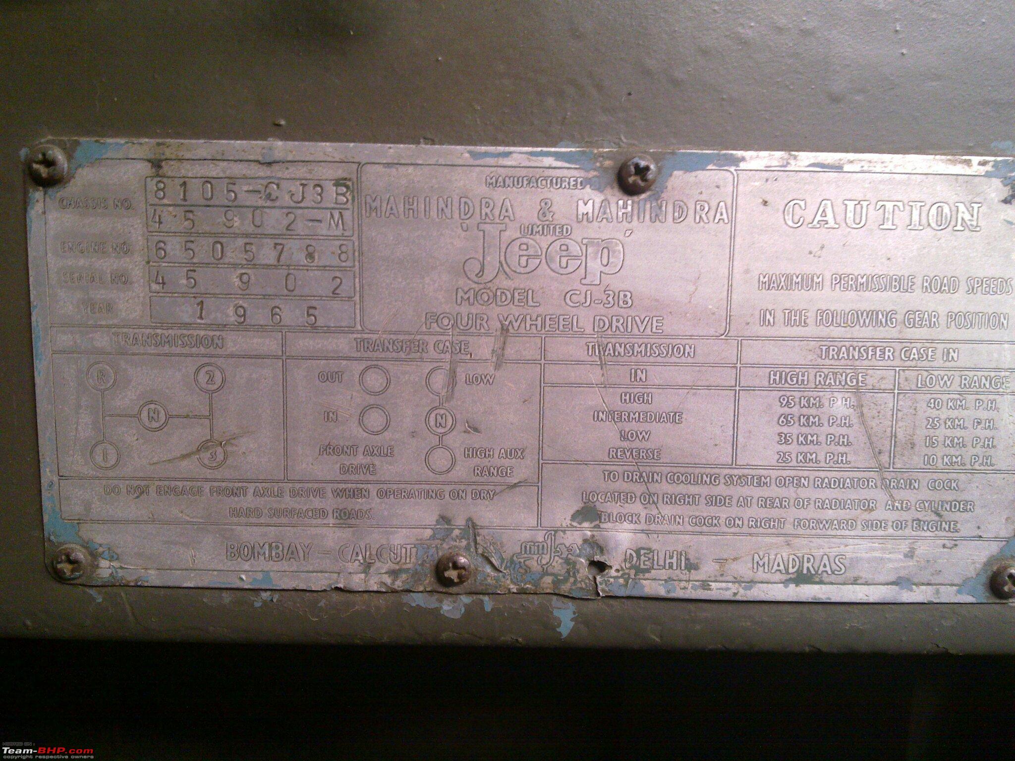

7. Photo of VIN plate from both locations (on dashboard and behind passenger seat on mudguard)
8. All meters.
9. Foldable seats in both up and folded position.
Exteriors

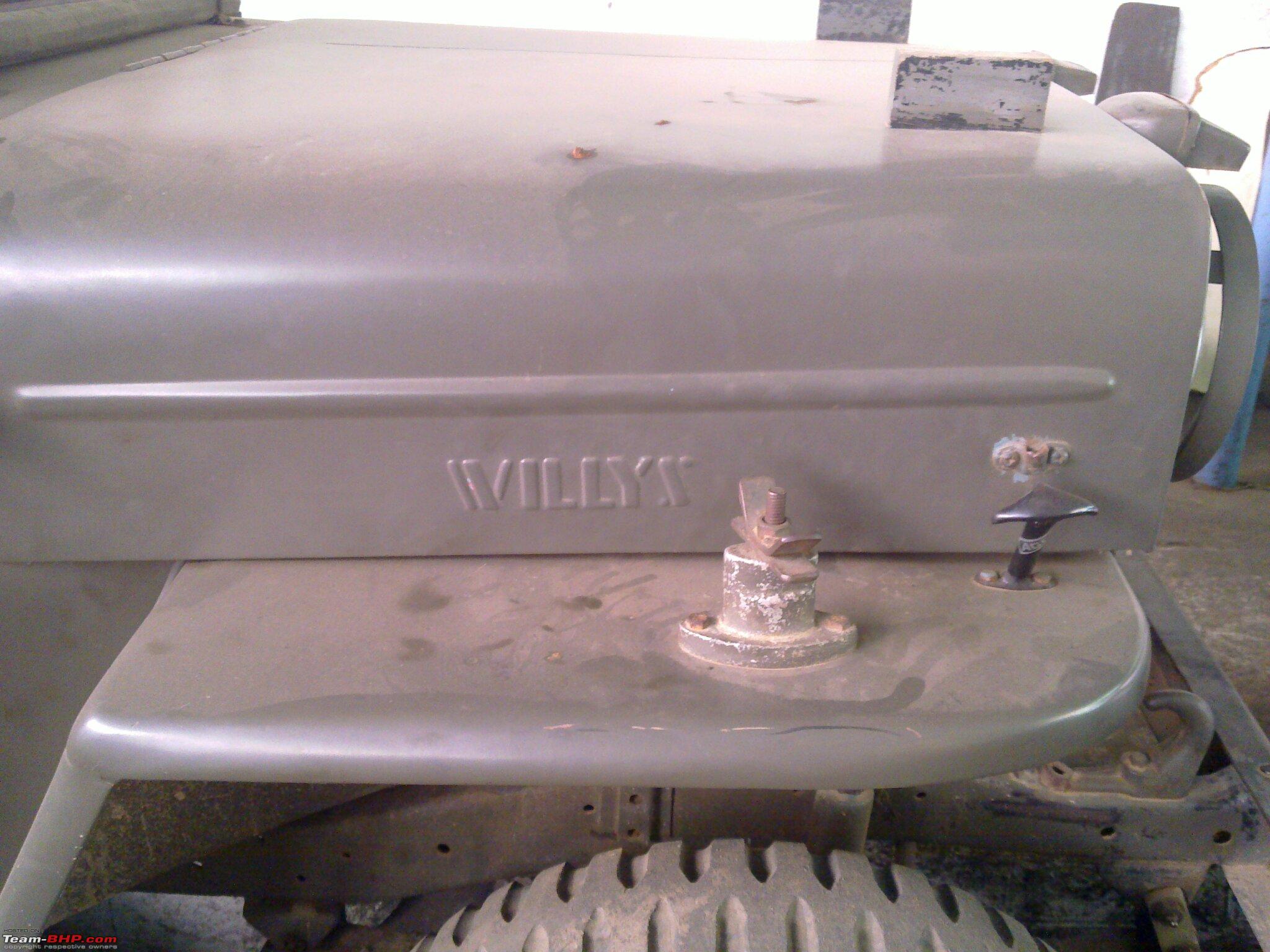

1. Front and rear from an angle left and right showing "Willy's embossed.
2. Front zoomed
3. Bonnet cover
4. rear side
5. closeup of the scissor top.
28th September 2010 - The Jeep is now ready sans the new steering kit which is on its way. It just needs a good scrub and The Hulk would be ready for the roads!!

Dear Shubz - that's a real good CJ3BLHD you have got there. Please be careful when rectifying the issues. I suggest you please PM me your contact number. I will guide you in totality. As regards the steering, there is a slack adjuster provided (the center screw and lock nut in the last photograph). Please see if your technician can carry out the adjustment. There is slack adjuster provided in the steering intermediate shaft also (behind the split pin in the fourth last photograph). The distributor (the part from where your spark plug wires come out) of your Jeep is original, seems to be Magneti Marelli, be very careful, as no service parts are available now. The choke on the carburettor is not fully closed, please do so or you will waste petrol and you will never be able to set the idling speed. Somebody has put a spark plug nut on the carburettor accelerating pump shaft. Please remove it. You will have to equip your Jeep with an electronic fuel pump with fuel return line. Please refer my comments to Jaggu in this regard.
Please do only what is required.

@ Behram Sir -Thank you and Very nice observations! I sure did even think on those lines. Thank you sir. With regards to steering, the slack adjuster has been checked and it seems to have reached End of Life (probably) and the only thing am looking at now is to change it to XLO which UBS sir is sending across. Nevertheless, I will try and convince the mechanic to take a look at the slack adjuster once again.
Choke - Yes I did notice a 4 to 5 mm slack in the choke switch and thank you once again for bringing it to my notice, I will have it fixed tomorrow. As far as idling is concerned, the engine idles beautifully now.
Spark plug nut - I will talk to the mechanic to see if that can be replaced with the original one, got to check for its availability too.
Electronic pump - There is an electronic pump to push in the fuel but not for fuel return line. Should I have another fuel pump (electronic) installed for the return?

With regards to the pics posted above, I had two questions.
1) In the pic depicting the Brake inspection plate (between brake and clutch), I notice that these are fastened by star screws.
2) the same goes with the VIN plate - fastened by star screws.
Did they have star screws during those days? or have they been replaced with the star screws now.
Best regards,
Shub

Originally Posted by Shubz View Post
To all,
Did they have star screws during those days? or have they been replaced with the star now.
Yes they had star screws, yours are original. Don't replace them.
