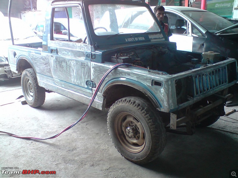

Hi , the engine which i had got has been sent back for a G16B as the G15A is -ve fit
Meanwhile the body work has started and also bought wheels and tyres for the gypsy. (FORCEUM 235/75-R15 on 8.5J wheels)

Nice wheels but why do you want to put them on when the build is happening, chances of damage are more and then things like paint over spray. Remove them and store them safe.
Thanks you sir , after i bought it i badly wanted to see how they look with the vehicle , so just put one in the front and one in the back just for the sake of a pic . Now they are safely kept in my showrooms's godown .
