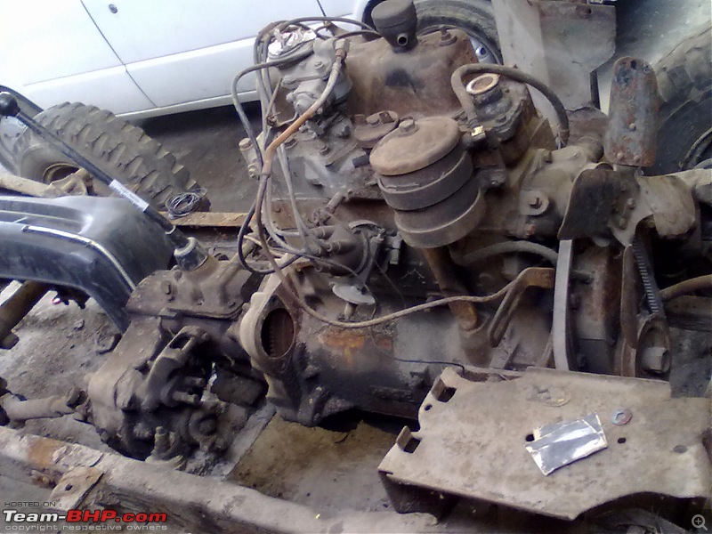

Update on the restoration:
The body tub has been removed from the chasis and is going to be worked upon, primarily the floor has to be completely redone. Meanwhile planning to work on the engine. As the engine seems somewhat okay, we are initially planning a ring job and flushing the engine and changing all oils. Then try to use it for sometime and decide farther course of action. Am taking this a bit slow as am very inexperienced and this is my first jeep. Meanwhile have come up with some queries.
1) Mr Behram had mentioned in some other thread about keeping the original solex carb main jet size between 127.5 to 140 and venturi 25. Now, I am not able to make my mech understand what a venturi is (as if I myself know too well..). Is there any other name for it in mech lingo? And what is its purpose?
2) Also I have seen in other 3B threads that it has got a chronic problem of overheating. So, I am planning on having at least my radiator well conditioned. Many of you are using 4 core radiator (don't know what it is). Can someone inform me whether I can use my existing one or a 4 core is a must.
Also pls take a look at my pics. The front prop shaft is missing along with the 4x4 gear levers. Can you pls inform whether it can be made 4x4 ready with just by having the prop shaft and the gear levers. As per my mech, the MM540 front shaft is a direct fit and these are the only things that are required right now to become 4x4 ready. Is it correct?

The solex carb

2) Please take a look at the steering box pictures. Its embossed "ROSS" and not "XLO" which I suppose is better. The spares guy is offerring a new XLO type box for LHD for Rs 5K. So shall I bite it and change the box or this ROSS one will also do? Current one is working it seems while towing.
