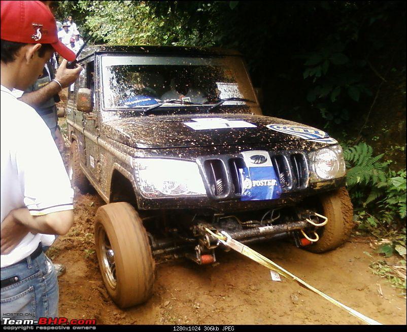

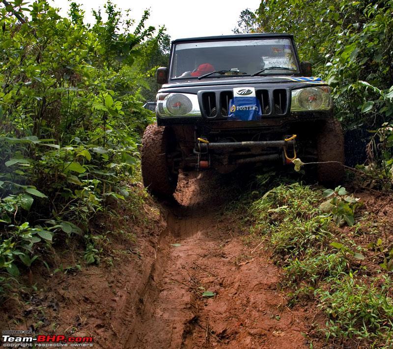

Spike it costed me @ 60000/- with Santen compressor and M&M blower.
.it was freezingly chilling.Unfortunately i dont have the engine bay pics.I sold the same and taken Major 4wd in 2010 for better offroading.
I can suggest South India Motors at coimbatore for the same.He has did a fantastic job.
