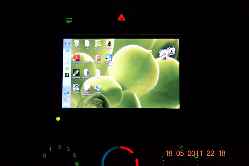

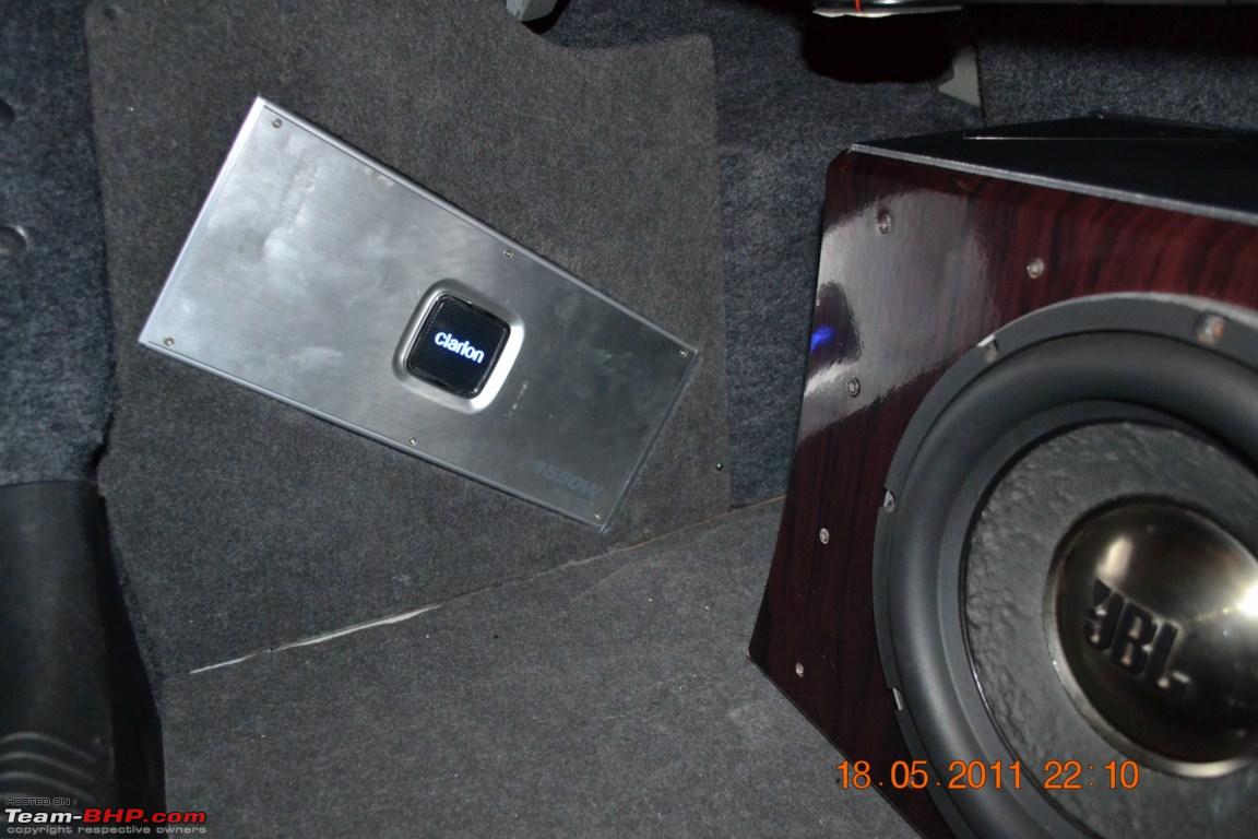

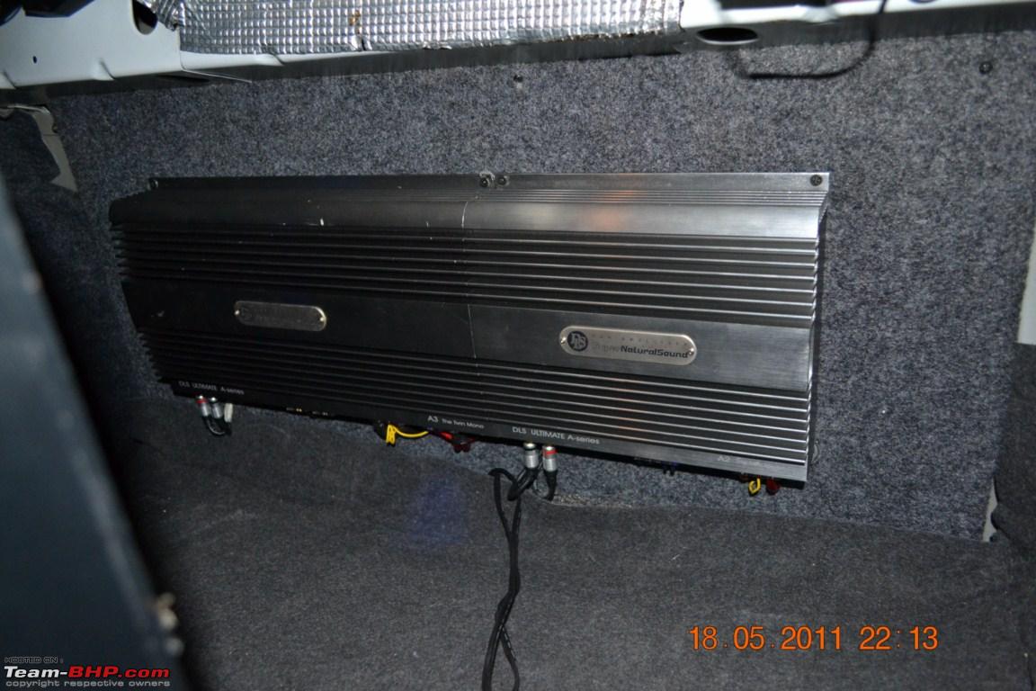

A few pictures, and a short video. Remember to switch to HD on youtube for good quality.
My camera battery went dead while shooting the video. So only 1/4th of it was saved. In the next part I will show you guys how seamless the operation is, and how fast the computer operates.

Let's end the confusion. I went down specially to take this video so everyone can see it. There are 3 videos.
One where I boot up from hibernate (like I do everyday)
One where I restart the PC to see how much time it takes for a cold start
One is a fun video with lots of stuff happening, mostly with Centrafuse and lots of other stuff. This video has a great soundtrack (music playing in the car) so you guys will enjoy it :-)
