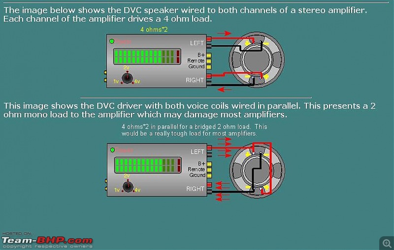

Tushar, how is the DVC sub wired with the 4 channel amp?

is it possible to wire with one channel dedicated to one coil and another channel for the other coil.
Yes it is possible, His amp will deliver 70watt RMS to each coil of the sub
Presenting a 2ohm load resistance will be a good idea if the amp is 2 ohm stable.
ICE upgrade : Maruti Swift-untitled.jpg
yea that is possible as far my knowledge goes
yes youy can do this as long as each channel 'sees' more than 4ohms you will be ok.
