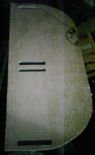

Here comes the first problem:
I intend to put 2 amplifiers. For now a CS60.4 to drive my 4 speakers. Later, a GTO601.1 (What to do ya, I can do these things) to drive a twin subwoofer box in the rear.
The rear seat does not have a hard metal back. I cannot mount the amps against the rear seat. I do not wish to mount a 601.1 under the front seat, where it will jut out and people will stomp it all the time.
I need to make a wooden plank, cover it with carpet and mount it on the back of the back seat, to mount the amplifiers.
The wiring will begin post that. It will take a few hours to make this.

Yeah do that as a temp fix but it can really be beautiful if you make the FRP-ply-FRP sandwich I showed B&T. 10mm thick and as stiff as granite. I think it is the simplest stiif panel one can make. stiffer than 25mm MDF.

Have now cut the plywood to the exact shape of the rear seat. This took a while

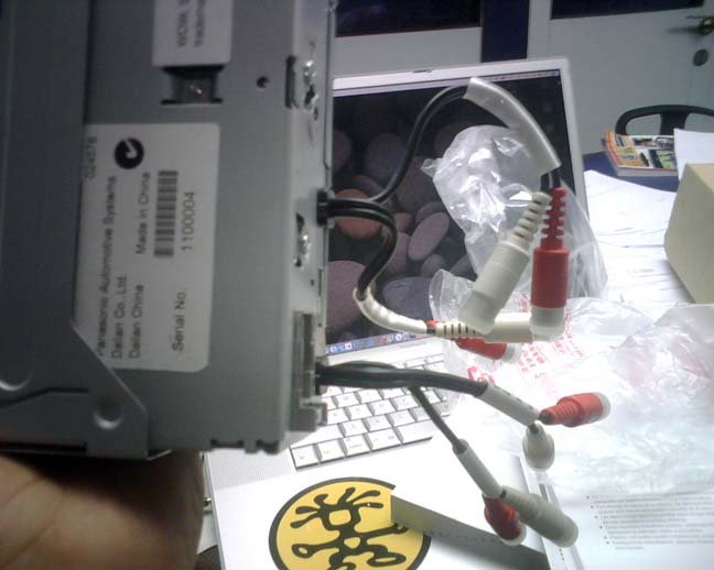

The report:
I am truly impressed. Nay, I am blown away. I did not expect it to sound like this.
The panasonic HU gets 5 stars from me. The features are fantastic and extremely user friendly.
It has everything you may need from a good HU. Aux in, high speed iPod connection (optional), front, rear and sub out. No BBE no bass engine no SLA, none of those annoyances.
The build quality is terrific. Though the graphics are not as polished as the Pioneers, the combination of R G and B (user selectable) makes an absolutely delicious display, that pictures will do no justice to.
The features are easy to use, even though there is a FAT book, there is no need to read it really. The user interface is super simple.The internal amplifier is supposed to be very powerful, and the user is able to switch it off.
The volume increase is gradual and with amp gains set to about 50% you need to go up to 25 to get it medium loud. (40 is top). There is no loudness control. which is fantastic.
The sound is balanced and very very sweet. Gentlemen I am very impressed.
Don't ask me price - I don't know, yet. BUT I would pay 20K+ for this HU without blinking. (if I had to pay)
I am very pleased with the new MX RCA cable. I did a one on one with my VDH hybrid and they were not too far off in my first listening.At Rs. 300+ I think they are stunning.
I do not have the high speed iPod bus cable, I am using an ep-rca into the aux input and am very pleased. With the bus cable I will be able to control the iPod with the remote of the Panasonic. Till then the ipod will rest in the rear console.
The treble is subdued and very sweet, the vocals are terrific. It sounds best on tone bypass(as expected)
I subjected the system to 3 Daves. Grohl, Grusin and Brubeck and I could not leave the car till each track was over. I am tired, sleepy and very very pleased.
Phase II will now happen in 2 or 3 weeks, where a twin Infinity Subwoofer enclosure will be hooked to a GTO601.1. The enclosure has not landed yet and I simply cannot wait.
