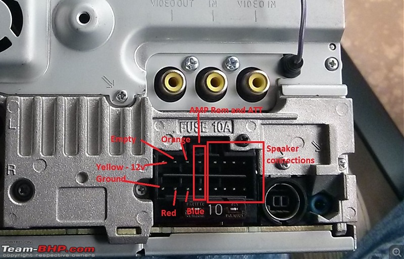

My head unit (Sony XAV 62BT) has DVD play back and the parking brake input needs a bypass to ground for DVD to work. I am not able to locate the pin position of the parking brake input. Since my harness is an aftermarket one, wire colors mentioned in headunit manual is not matching up.
It should be one of the orange, empty or blue inputs.
I tried with blue, but its not working. So it should be either orange or empty slot.
The auto dimming when lights are on works, so I will need to check if the orange is getting a 12v when lights are switched on; if that is the case its the empty slot that is for the parking.
a. How to make a proper connector at the empty slot if that happens to be the parking input? Is there a way I can take the amp rem input wire and use? I dont have any crimping tools or pins with me.
b. I searched online to see the 16 pin diagram for my headset, but couldn't find one. Any pointers?

Originally Posted by arjithin View Post
... I am not able to locate the pin position of the parking brake input. Since my harness is an aftermarket one, wire colors mentioned in headunit manual is not matching up. ...
There would (should) be a connection diagram stuck on top of the unit - refer to that to know which pin is "Parking Brake". Parking Brake? Why would the unit need that? This must be the input from Reverse light to switch to automatically switch to reversing camera, IMHO.

Default Re: Queries in 'Ask the gurus' section
There was no diagram on top of the unit, hence asked the question.
Parking brake input is used to enable video playback. In many Western countries it is illegal to play video in front dash while the vehicle is in motion. Video will be played only if the parking brake is engaged (for manual transmission) or if the vehicle is in park mode ( automatic transmission). In order to bypass this limitation, aftermarket sterios are wired to have this input connected to ground via a switch, so that if a cop asks to play a video while the vehicle in drive mode, people can disengage the switch and escape fines.
I was trying to locate that pin and found that it's the one marked as blank in my above diagram using trial and error method.
arjithin is online now   (1) Thanks Reply With Quote
