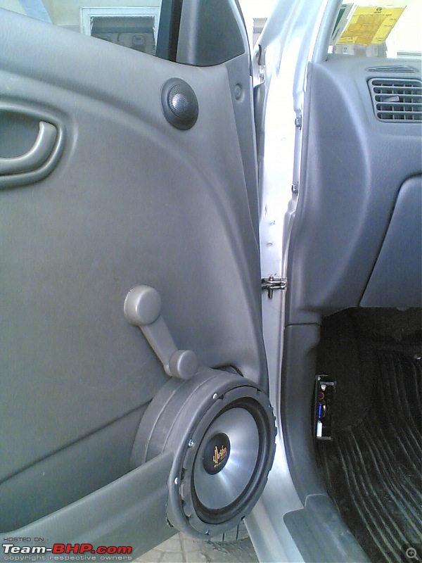

the illusions are the best VFM components that i have heard during my auditions.the sound is very natural and sweet, not bright at all. also the drivers give a nice accurate bass. the tweeters have amazing clarity and dont give the jhankar beats "chan chan" noise at all. i had to put in lot of efforts to put those 6.1 in alto door trim. but the installer did a perfect job by cutting the trim. i used 3 spacers which i screwed tightly to the sheet metal along with the fibre, and voila i dint need any damping. though high bass and high volumes bring in vibrations only in the left front door. will go for damping later on.

1. Illusions. the finishing on the spacers and the grills on the compos are still pending. will get it done soon.

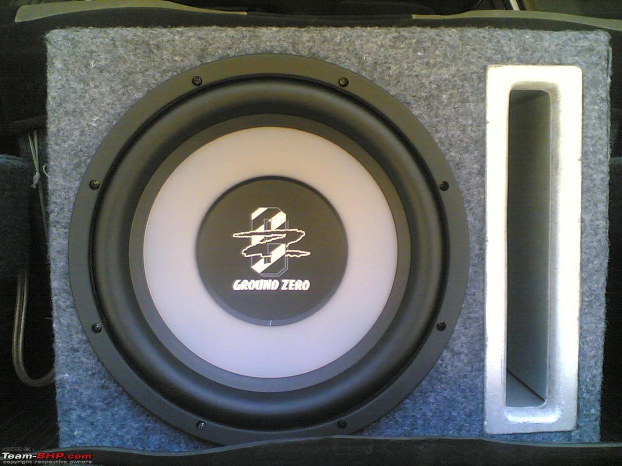

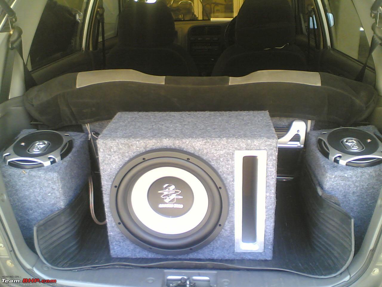

2. The GZ MK2 sub and the rear speakers. the cloth cover over all the boxes are complete DIY and was very painful to cut the cloth to the dimensions and stick it over the boxes with TEXABOND. spoilt the whole sunday and my room was all dirty.

Nice setup. Hope the crossover doesn't interfere when your pressing teh accelerator.
How about some pics of the subwoofer and amps in the boot?

3. The JBL and Dyanamo Amp fitted at the back of the rear seat. I bought a big piece of ply covered it with the same cloth and then screwed it to the bars of the rear seat. alto doesnt have sheet metal the the back of the rear seat. both the amps are screwed over the ply.

no it doesnt interfere at all. actually in the snap it looks as if its very close to the pedal. but laterally there is huge gap between the pedals and cross over.

Any particular reason for not fitting the grills on those electra drivers ?

I have the same question as aditya does and also why crossovers are fitted there?
