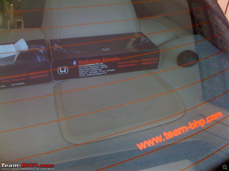

Some post install pics.
The pics I took during install is in my friend's camera. Will upload them soon.
Honda City JBLed-img_0099.jpg <br /> <a href=Honda City JBLed-img_0100.jpg <br /> <a href=Honda City JBLed-img_0102.jpg <br /> <a href=Honda City JBLed-img_0103.jpg <br /> <a href=Honda City JBLed-img_0104.jpg <br /> <a href=Honda City JBLed-img_0105.jpg <br /> <a href=Honda City JBLed-img_0107.jpg   <div style=
