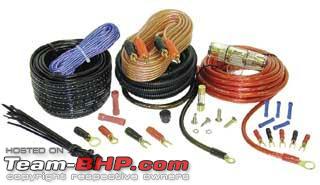

Got Stinger amp installation kit today. Got it at a very good deal.
My Alpine CDA 9886.Will get my hands on it in July.
