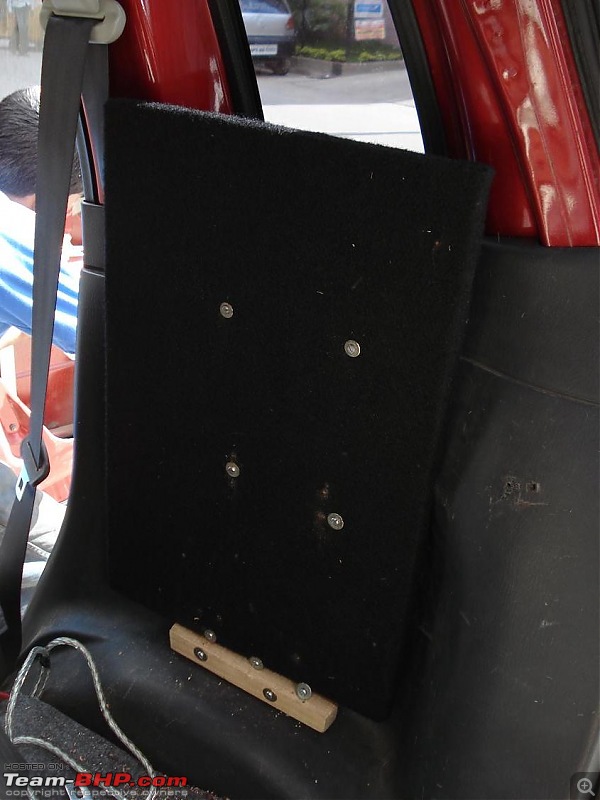

Ultimate brand rear co-axial speakers ( 6”X9” 240W max) on a plywood board.

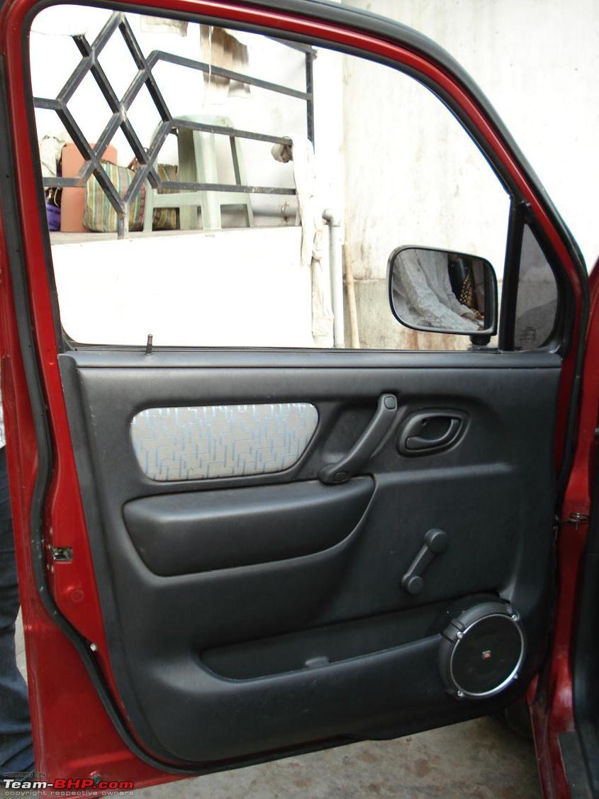

HU: the old pio 2750(if I am not wrong again, with 1 pre-out was replaced) with Pioneer 4050 USB HU.
Front sound stage were a set of JBL GTO 608c, replacing 4" pio coaxials

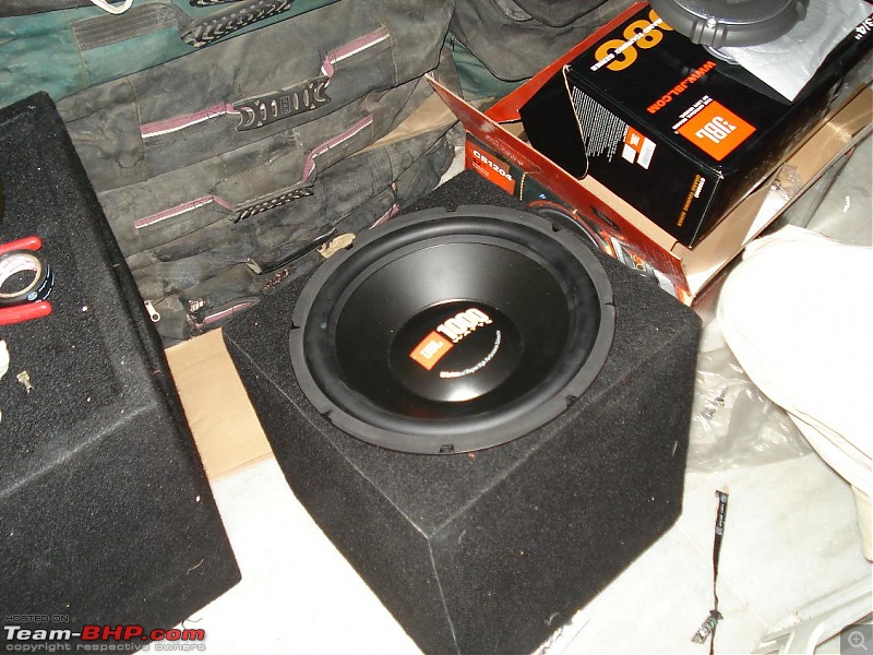

Sub is the JBL CS1204 in a custom made very very compact box that would not eat a lot of the wagon's boot!
Rear fills were the ULTIMATE brand speakers 6"X9" 240Wmax previously and currently powered by HU.

i insisted on NO REAR FILLS but ravi dint want the speakers sitting at home and slowly lose them in his garage i guess, so we just put in the rear fills and the best way to save a good luggage space was the rear door.
