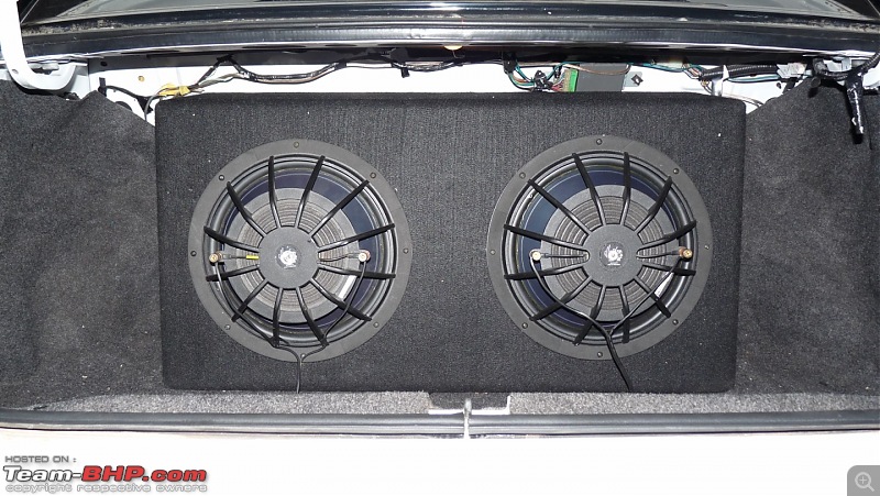

some photos of the subs in the boot.
Frankmehta’s eS(Q)teem®: Eclipse| Illusion Audio| DLS| Genesis| Monster|Hermit-p1010704-desktop-resolution.jpg
Frankmehta’s eS(Q)teem®: Eclipse| Illusion Audio| DLS| Genesis| Monster|Hermit-p1010705-desktop-resolution.jpg
Frankmehta’s eS(Q)teem®: Eclipse| Illusion Audio| DLS| Genesis| Monster|Hermit-p1010706-desktop-resolution.jpg
Frankmehta’s eS(Q)teem®: Eclipse| Illusion Audio| DLS| Genesis| Monster|Hermit-p1010703-desktop-resolution.jpg
