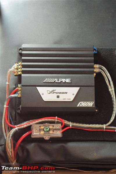

Next the amplifier got changed to Alpine MRP F240 (used). Its a discontinued amp. But to me the 40W/channel from the alpine amp is much much better than the 60W/channel from the JBL. The compos and the sub sounded much cleaner.

1. Alpine MRP F240 4 channel amplifier

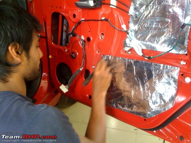

Yes, I have done some damping.
Front doors of swift are held only by a few clips. LOL!
I have damped the front doors and the boot lid. Here are some pics. I was not there when the boot lid was damped. The installer seem to have put some nylon puff (or glass wool) inside the boot lid. It feels heavy and opens with bit difficulty. I fear it may eventually damage the hydraulic system.

what type of damping is inside and on the door,5.5k for this much damping as seen in the pics is expensive.
