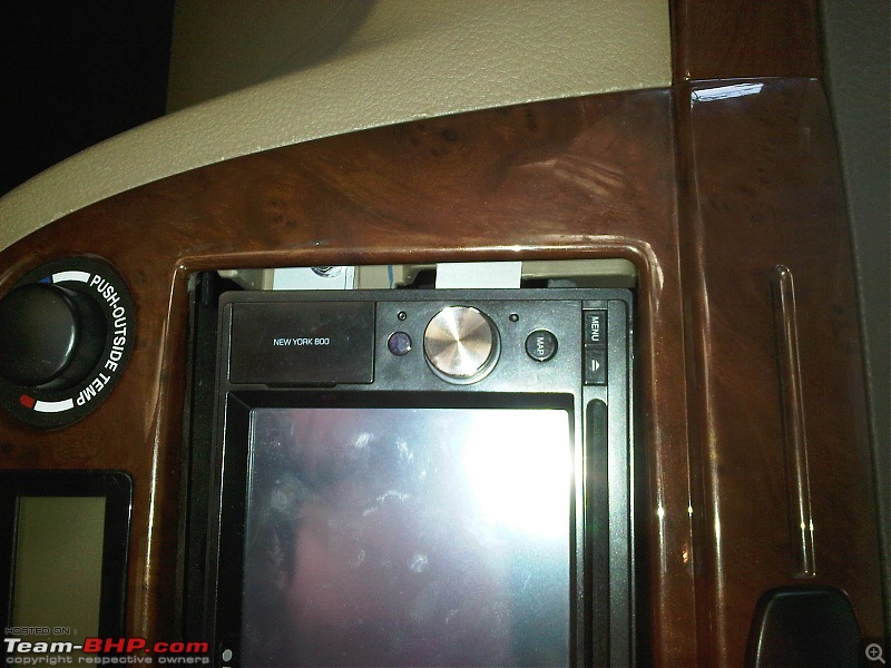

Gurus - need help. don't scold me for opting a bad installer. Now i need to correct it how ?
I repalced stock 2-DIN system of Optra with Balupunkt. Now HU dimension is small. Hence gaps. Even the kit came with HU is not fitting correctly. Now what? Attaching the pic so that you can have a view.
Other problem - developed since last one week. When i switch on the car HU starts. But if i have to off the HU its not taking input from on-off knob, rather it's taking input from Menu button ( Beside the eject cd button). I can switch on - off HU with the Menu button but there is no way if i don't want the HU to start with the engine. What went wrong in this case?

It seems like the Optra OEM HU is larger than 2 DIN. The Blaupunkt trim plate would buy you 2-3mm at bet. This gap looks more than that. I dont see any option other than fabricating a custom trip plate for the Optra. There are gaps on all 4 sides from what I can see.
As far the on-off issue is concerned to be honest I did not understand the query. If your HU comes on when you turn then engine on maybe yuor installer are wired the power wires incorrectly.
Thank your Navin Sir for trim suggestion. Even i thought so, now need to find someone who can make a custom trim.
For On Off problem : this was working perfectly till last week. I installed 2 months back. All of sudden it developes this issue. Is it possible that wiring goes on toss all of sudden? Big doubt i have is how come it's getting on - off from the menu button. Is it some software/Virus issue of the system? Now i am not using the system, will be taking the car to installer for checking the wiring. Not able to find a good installer who can do the only wiring part in Pune.
Maybe not a virus, maybe some electronic part failure. That is what I suspect.
... I can switch on - off HU with the Menu button but there is no way if i don't want the HU to start with the engine. What went wrong in this case?
... If your HU comes on when you turn then engine on maybe yuor installer are wired the power wires incorrectly. ...
Definitely wrong wiring. @aditya@pune, please help your installer correct it by getting the red and the yellow (could be yellow/red) wires from the harness wired correctly to the HU by reading the terminal diagram on the HU (would be in the manual too). Red goes to ACC in the rear left bottom most connector, and the Yellow (or yellow/red) goes to BAT+. If the ACC wire is connected to the battery directly (as it looks like in your case), you can operate the HU even without turning the key on, since the ignition switch is bypassed.
Thank you Navin Sir and DerAlte. Will talk to installer with your suggestion and comeback if something new comes up.
DerAlte: Can you suggest where i can get the custom trim for my system? If you can source one in Banglore I can collect from there. I will be in Banglore next week.
