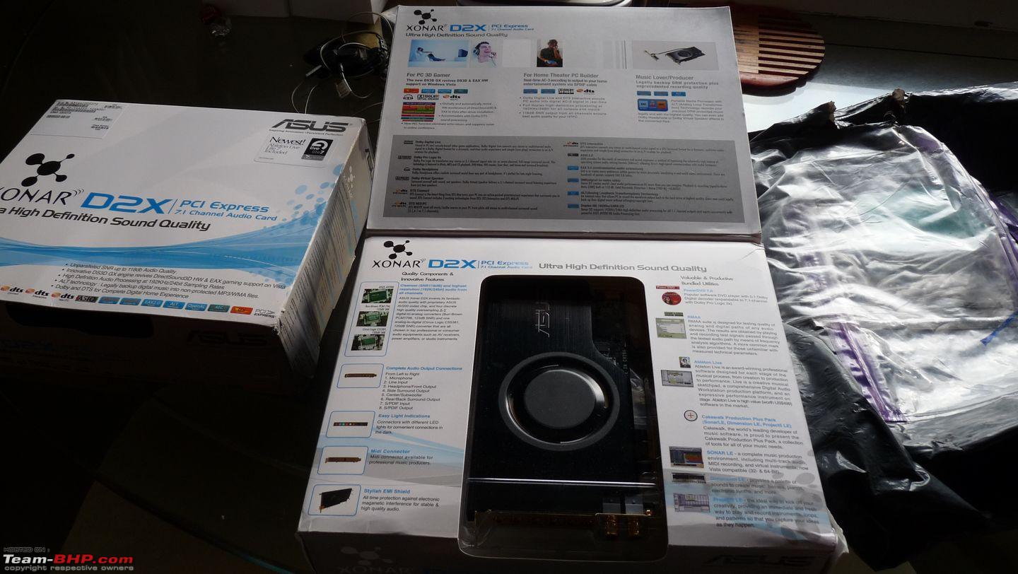

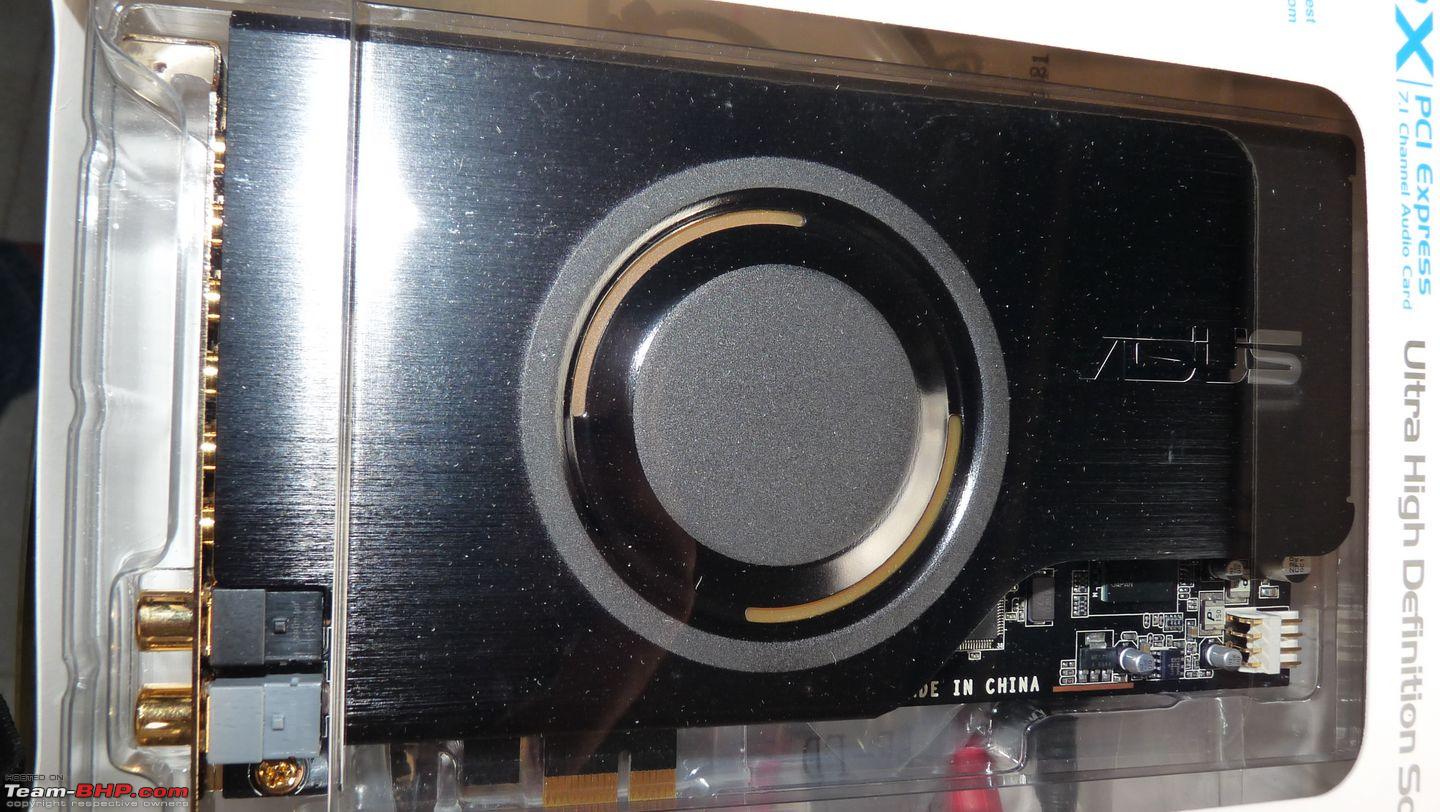

Some photos of the sound card that arrived in it's mail this week:
An Audiophile Computer in the making: frankmehta's Fiesta S-p1060045-desktop-resolution.jpg
An Audiophile Computer in the making: frankmehta's Fiesta S-p1060046-desktop-resolution.jpg
