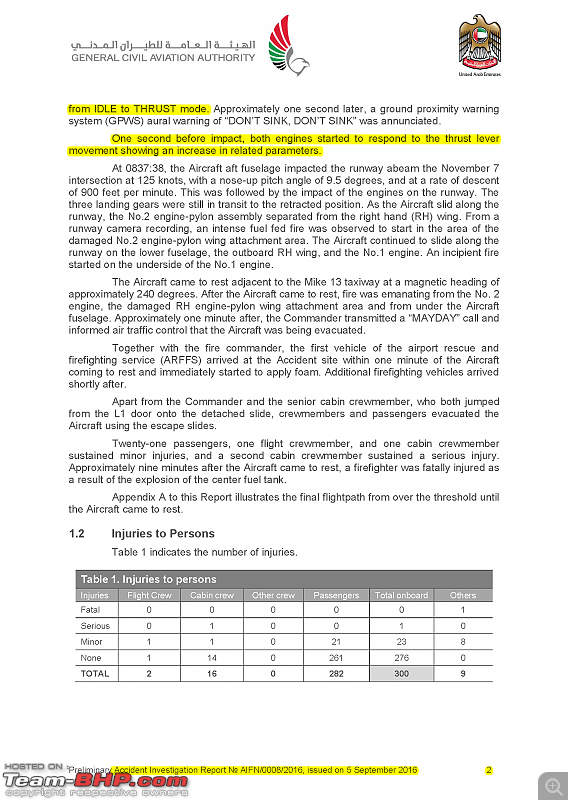

Originally Posted by searchingheaven View Post
EK521 preliminary report released. It's very comprehensive. But I didn't get the time to go through it. If someone can do so and summarize, it would be great.
So I just went through the report and I must say that I am aghast. They are consistent with my earlier observations in post#312. Here is the gist of it. Other pilots, please correct me if I am wrong in my observations. Important sections highlighted in yellow.
0837:12, tailwind to headwind change, due to which the aircraft landed 3600 ft farther down the runway.
0837:17 - right main gear touchdown
0837:20 - left main gear touchdown
0837:19 - RAAS warning - long landing - long landing
0837:23 - Go-around decision made. Aircraft pitch changes.
0837:27 - Flap lever moved to 20.
0837:29 - Landing gear lever selected UP
0837:35 - Thrust levers firewalled
0837:37 - Engine responds to levers, but it's too late
08:37:38 - Aircraft falls flat on it's belly, with gear still in retraction phase. Just FYI, it takes 12 seconds from lever UP selection to all green.
There are so many things wrong with this incident that I don't know where to start. Some important points:
  1. Windshear was present, but not the reason for a go-around. The crew decided to go around due to a long landing i.e landing farther down the runway than normal.
  2. Considering the fact that there must've been a windshear warning due to the sudden change in wind direction 5 second before touchdown, the procedure followed should've been a WS recovery procedure, not a normal GA.
  3. Even if the crew was attempting a normal GA, gear retraction before conforming positive ROC is an absolute no-no.
  4. In this case, forget ROC, the thrust levers remained at IDLE for 12 seconds after the decision to GA was made. I just cannot understand how this happened. There is only one scenario I can think of. The crew pushed the TOGA button while the aircraft was still on ground. In this case the switches are inhibited below -2 RA until the aircraft is over 5 ft RA again. They did not realize in the heat of the moment that the thrust levers hadn't advanced to GA thrust.
    Although my FCOM clearly states and this is drilled into us during simulation that both PF and PNF have to verify/adjust GA thrust before gear retraction. The inquiry clearly indicates that the Emirates aircraft was still operating with idle thrust, and slowing down, as it attempted to climb away. I just cannot believe that this actually happened.
It is sad but a credit to Boeing that all lost 777s have been no fault of the plane itself. Only human intervention has lead to the loss of 4 hauls. I remember pondering a mere 2 years ago that 777s were flying over 10 years with out an accident. Not for one minute could I have believed a couple of years later 4 would be destroyed in unimaginable circumstances.
Boeing 777 - Pilot's Review-pages-20162016-preliminary-report-aais-case-aifn00082016-a6emw_page_1.png
Boeing 777 - Pilot's Review-pages-20162016-preliminary-report-aais-case-aifn00082016-a6emw_page_2.png
The first time I read this report I just couldnt believe it. I thought I must be reading it wrong. But it looks, for whatever reason, the crew really messed up.
In essence I appears they attempted a Go around without thrust (TOGA button was disabled, they didn't firewall the throttles), to boot they retracted the gear way to early compounding to their problems.
