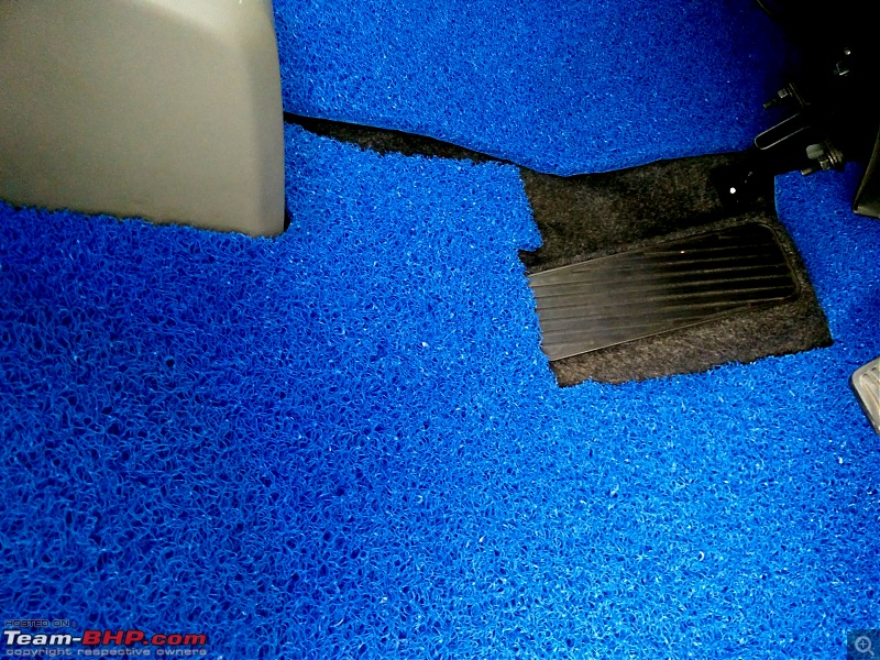

DIY Nomad Style on my Fiesta Classic

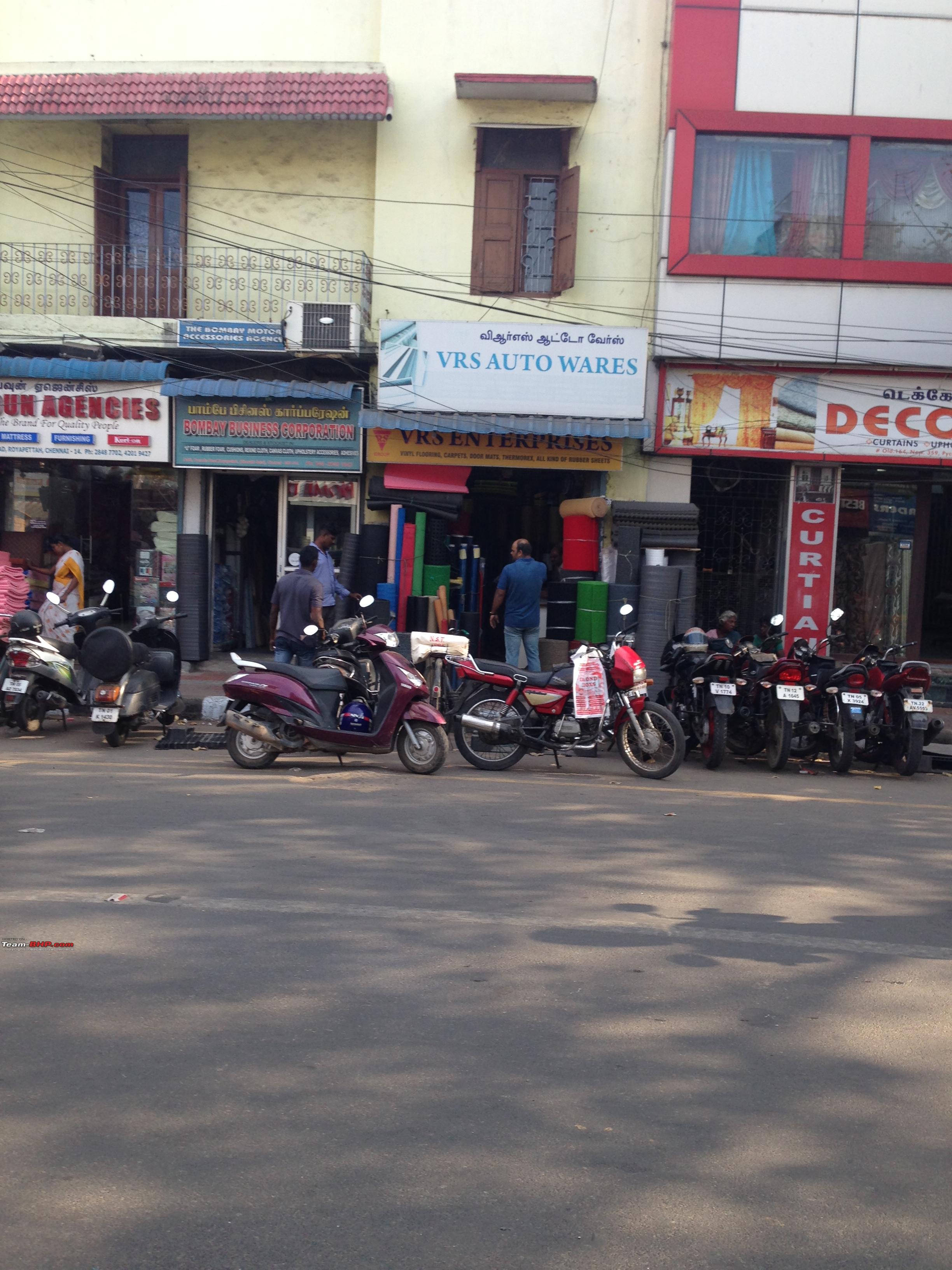

As mentioned in the earlier posts, I went to the road opposite to the express avenue mall leading to the beach (In simpler terms its Pycrofts road and Westcott road and other smaller roads around it. If you go there, you can do well to plan a visit to near-by General Patters road too which has loads of automobile stores and buy niceties for your ride).
Back to the DIY, I just entered the Pycrofts road and bang on the start of the street I saw this place - VRS auto wares. The entire line is with so many decors and carpet stores - you can just enter any shop. You can see the wound up of the loop mats of various colours on the pavement.

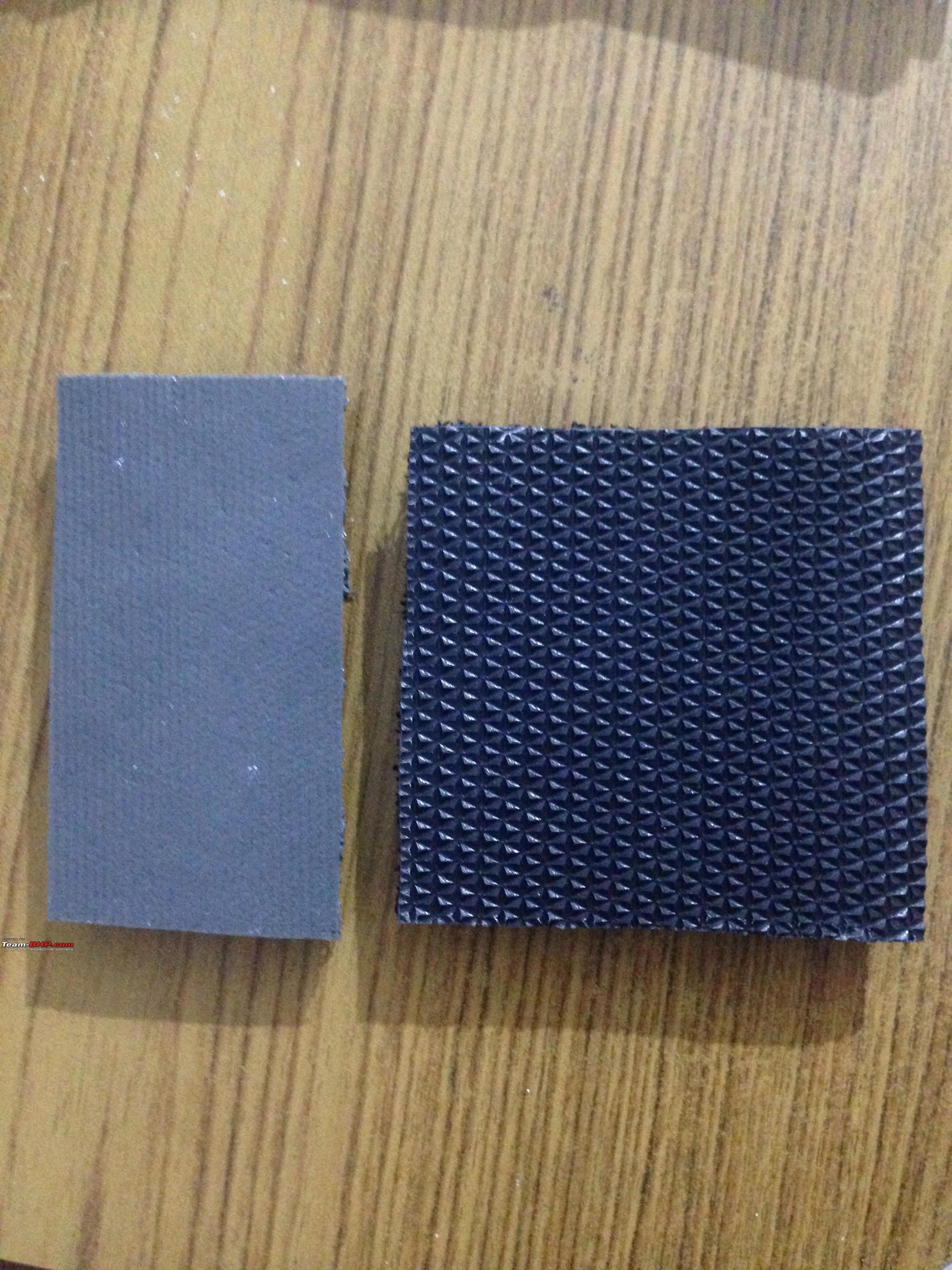

Comparing the 3M mat and the local one. You can clearly see the bottom for 3M is rubbery and thick whereas the local one's bottom is just a plastic sheet where the loops are attached.

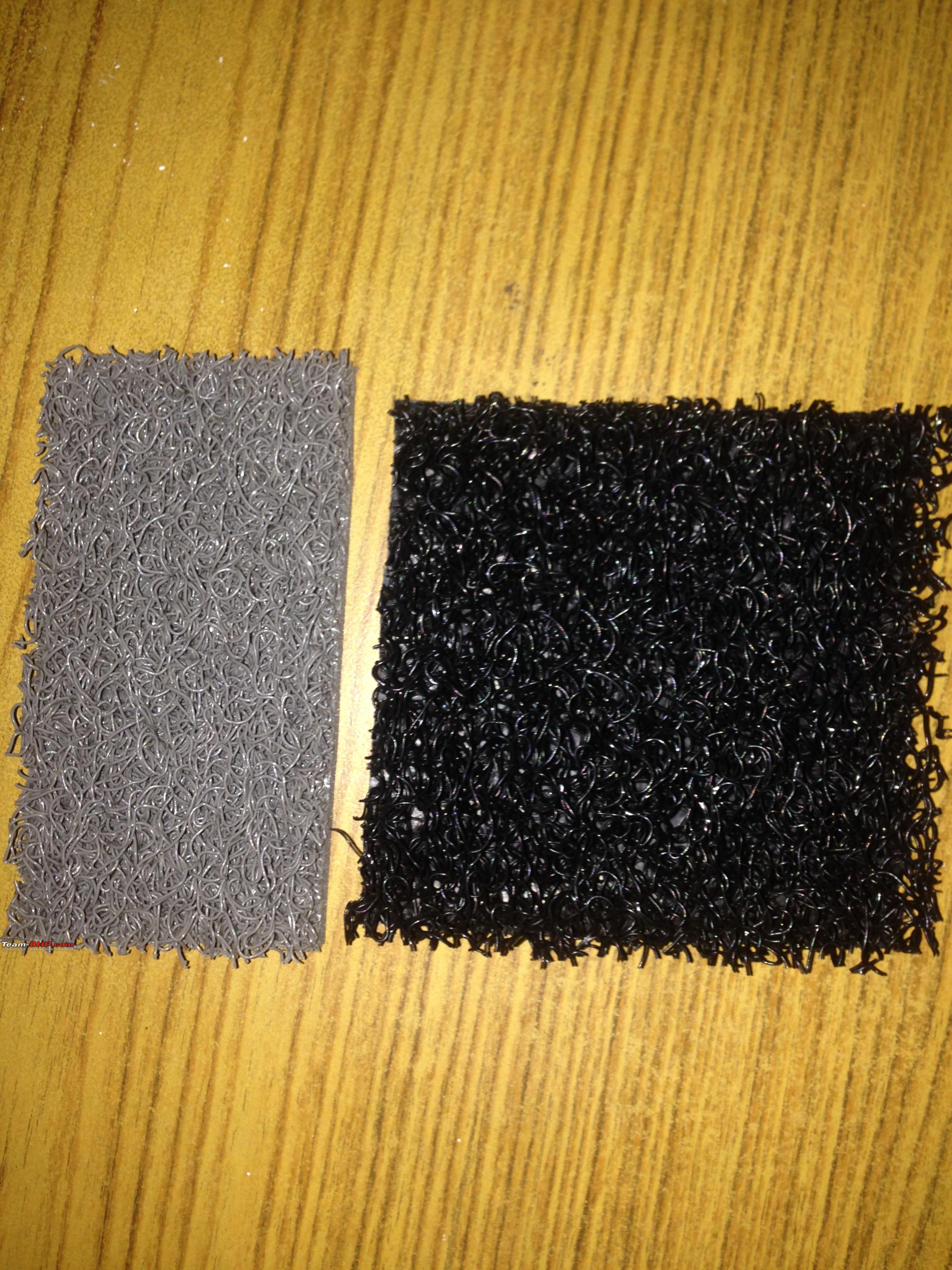

The one I bought has "softurf" written on its back.
Tocuhing the loops, the 3M mats feels lot more softer to the stiffer loops of the local. I do not find any difference in the loops arrangement or the packing per inch.

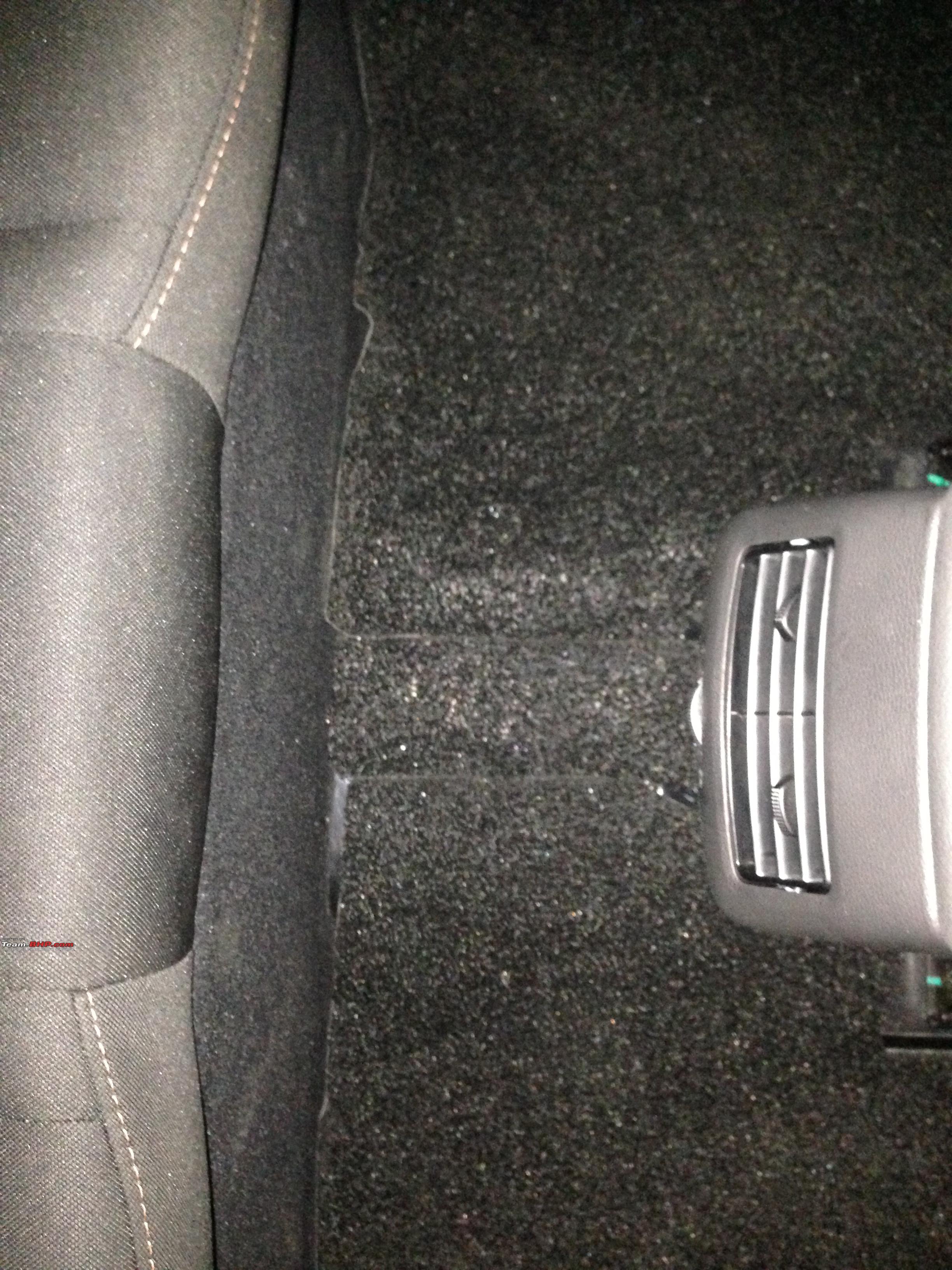

Back: All the way under the front seat. Back mat extends under the front seat and covers space under the front seat.
Initially I planned a one-piece back mat but I did a mistake in calculation and had to place a smaller piece to cover the gap

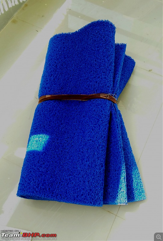

Today, i finally decided to give my KUV100 some nomad style mats.
Raw material. 2*8 feet mat @ 1300 rupees.
