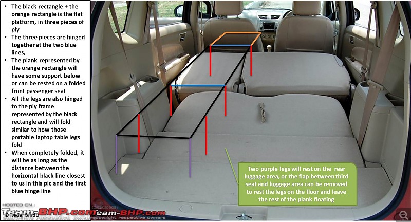

This is amazing, and this is why I love Team BHP. The same thought has been running through my mind for quite some time. I was pretty confident that this is where I will find like minded people. When I told about this to my family, they laughed at me, and when I persisted with the idea, now they are concerned!
I also saw the top gear episode (and there were couple of them) and the idea really fascinated me.
Not just Ladakh, but this kind of arrangement can be used while touring/camping anywhere else as well. Of course you need a company who is just as nuts as you are about touring/camping. Just park at a pertol pump, or near a hotel, or a spot with a nice view, get a portable barbecue to cook food for the night, and just drive through the day
Now since this thought came to my mind, I have been making some plans of my own for quite some time, which I will share here. But before that, few disclaimers -
  • I recently bought an Ertiga, so all my thoughts and designs are on this car
  • I have dreamt of owning a Scorpio for quite some time, but couldn't go for it this time because of economical constraints (The economics of living with it rather than buying it). So I am hoping you can do this successfully for me to follow once I get my own Scorp
  • These are still all on paper (actually powerpoint). I have not actually measured the insides of the Ertiga but will soon do it one of these next weekends
These are the requirements that I was working against -
  • I don't want to remove any of the seats, or do any welds to the car
  • So I was looking for a solution that can be setup on top of the existing layout, folded away easily when done
  • I think if we can get a flat surface that is parallel to the ground, and can sit on top of the folded seats, we will be able to use it as a platform to place a custom designed mat and sleep on it
  • It would be good if two such solutions can accommodate in one car, so that if you are going in a group, you can have two patrons driving and sleeping in each car. Helps to have some company and a co driver for the drive
OK now here's what I thought:
Here is one view of the arrangement
DIY: Sleeping Bed in a Scorpio-ertigabunkbed1.jpg
Here is the side view
DIY: Sleeping Bed in a Scorpio-ertigabunkbed2.jpg
Here is what it will look like when folder
DIY: Sleeping Bed in a Scorpio-ertigabunkbed3.jpg
  • A similar setup can be created to be placed behind the driver's seat, and you can have two beds in one car (albeit a bit narrow)
  • The height of the platform can be as tall as we want, and the area below it can be used for placing the luggage while sleeping
  • While driving around, the platform and the mattress will be folded in the trunk, so safety will not be hampered
  • Elastic ropes can be used for holding the folded platform together
  • I will start interior work in my new home soon and will ask the carpenter what it will take to make something like this
If the Scorpio seats fold flat like Ertiga's, you can use something like this and not worry about removing the seats. So what do you guys think?
KedarB is offline   (3) Thanks Reply With Quote

Do the seats in a scorpio fold down all the way like this?
I think that is only on the XUV? Getting the seats fully flat is a problem - tried it once in a friends car and was very uncomfortable.
COUGAR is offline   Reply With Quote
Well planned dude. You are on the right track. Keep us updated about your experiences with the setup.
You are right Cougar. The Scorpio doesn't have flat bed seats , so this kind of a setup will unfortunately not work for us.
