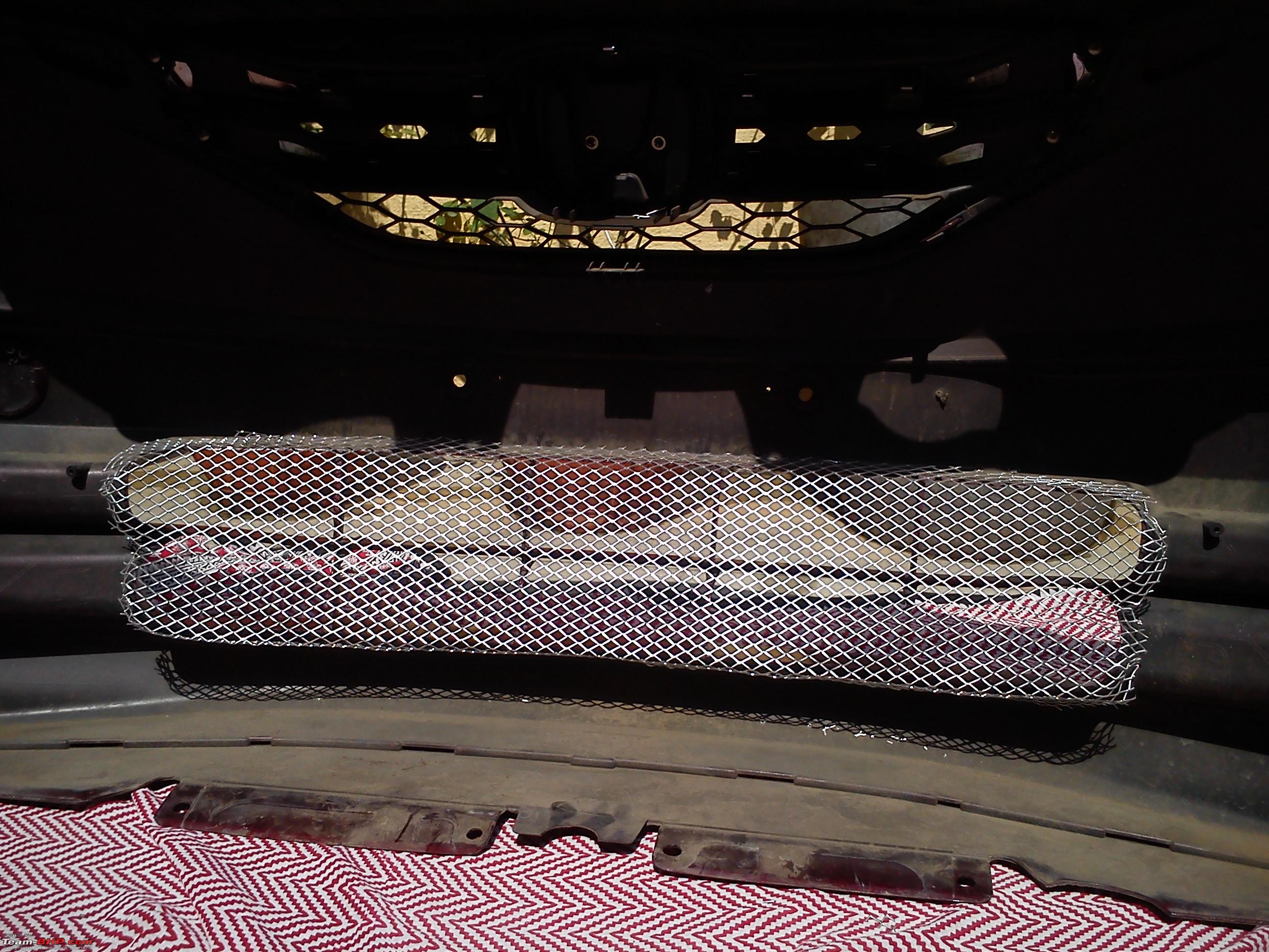

5. The focus now shifts to the piece of mesh, I personally prefer the silver color since my car is a dark shade so I didn't paint it. Keep the mesh on top of the portion to be covered and cut to size using a cutter.
Please do this with caution as the mesh has sharp edges.

6. Once the mesh is cut to size, use your hands and fold them into the shape of the air dam careful not to cut yourself and also take care you don't break it while bending.
7. I used M-Seal to hold the mesh in place rather than drilling holes in the bumper. The advantage of using M-seal is that the whole process is reversible with negligible evidence of any tinkering have been done.
8. The M-Seal, 2 packets was mixed and applied at the corners first and then along the length at required intervals. I used masking tape to hold the grill in place which the M-Seal hardens.
DIY: Mesh Grill (Honda Amaze)-dsc_0107.jpg
DIY: Mesh Grill (Honda Amaze)-dsc_0108.jpg
DIY: Mesh Grill (Honda Amaze)-dsc_0109.jpg
DIY: Mesh Grill (Honda Amaze)-dsc_0115.jpg
DIY: Mesh Grill (Honda Amaze)-dsc_0116.jpg
