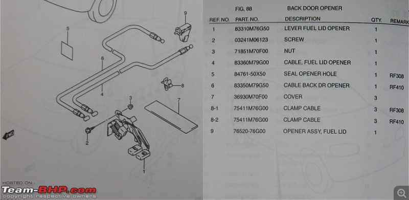

Post Alto - Rear hatch lock & remote release - parts
Hi, the relevant parts from the Alto's parts catalog - RF308 refers to the Alto Lx, RF410 refers to the Alto Vx. The first pic is the rear hatch lock assembly:
It appears that the rear hatch 'striker' alone needs to be checked for compatibility with remote release. The second pic is the remote release levers & cable:
Remote Boot Opener in ALTO LXi - Edit: Info on Pg 3 & 8 and a Detailed DIY on pg 13-hatch_03.png

i think we can put the cable similar to alto VX and route it below the seat. but you will need a lever as srini posted in above part list.
i will try to check the VX lock system and cross check it with LX.
