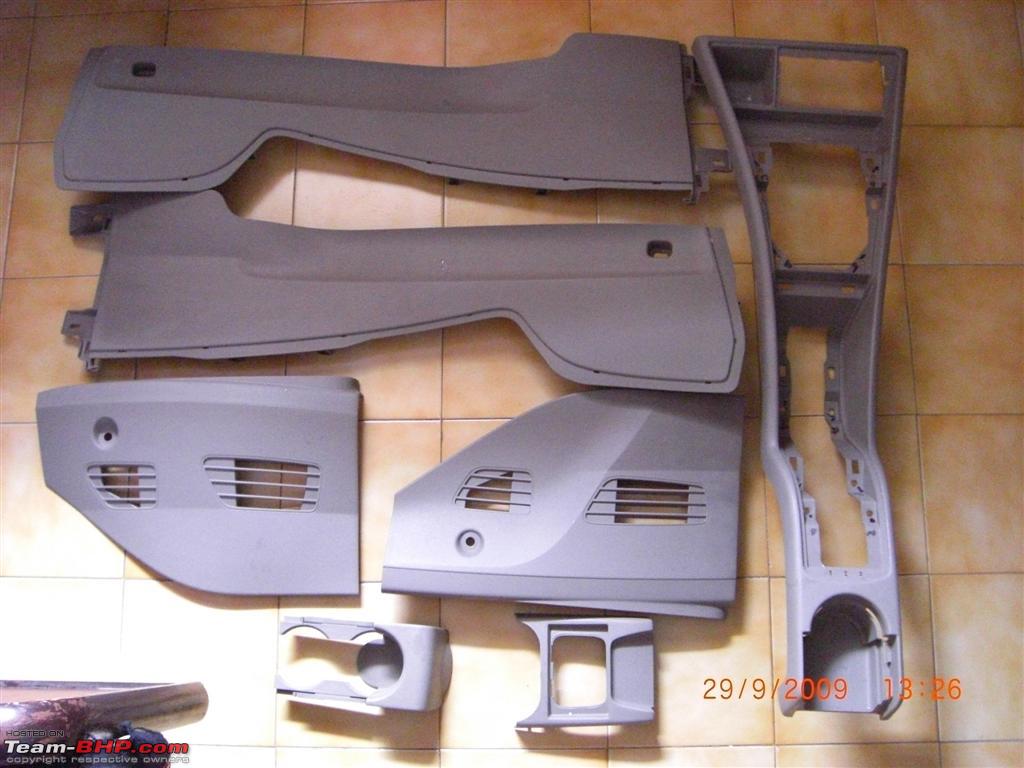

Removed the entire centre console-about 6 screws holding it.A/C ducting was also enclosed with 2 plastic panels,removed them too.
Bought red n black spray paints.Washed all the panels with soap and steel wool to ensure paint adhesion.Left them to dry while I went paint shopping-had black paint from a previous DIY,so picked up a can of black and red paint each.

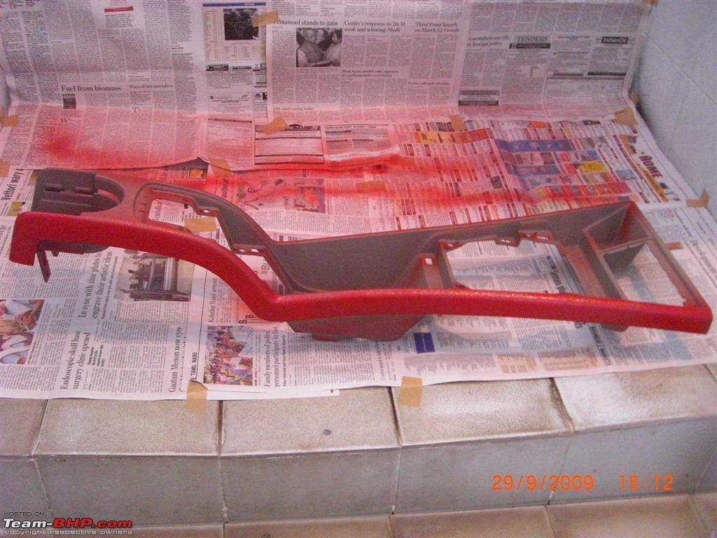

Sprayed the center spine and vents red-waited for an 30 mins to ensure complete drying before spraying second coat.Masked the vents and painted black-left all panels to dry overnight,as weather was very cloudy and then rained.

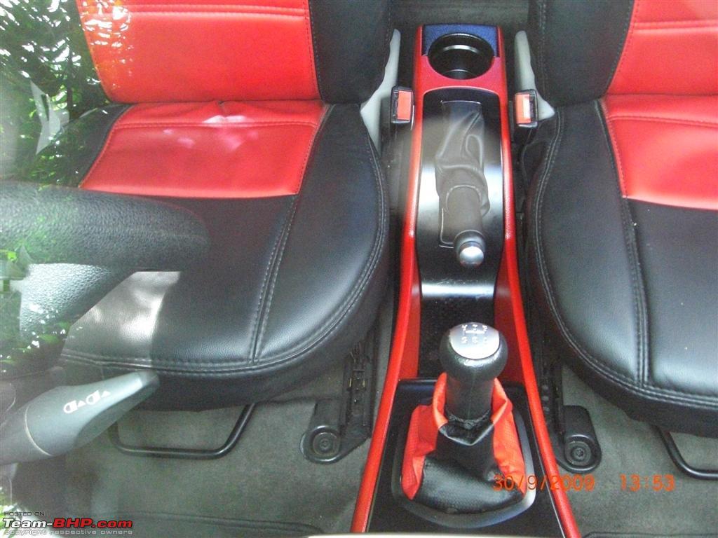

Morning ensured all panels were dry before assembling them and then fitting it back on the car.Must say,the console matched perfectly with the seats.

Wolffe, great job with the DIY. The color gels really well with the seat cover color combo.
Personally, i would have preferred if the air vents were also painted black, and not red. It would have been better of they were not made to stand out.
