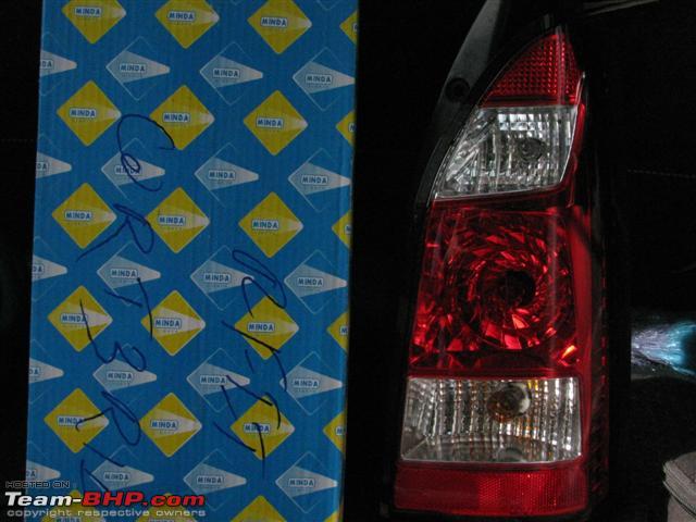

I procured and fitted the tail lamp that got broken some time back and I had done some jugad by applying a lot of transparent tape over the broken part.
Sad thing: it didnt want to last the monsoons, so I had to spend 850 INR on the full assembly.
The OEM is Minda. Also did some cleaning behind the assembly when I found it to be very dirty.
I got it from the accessories shop "Baby Enterprises" at Shyambazar, Kolkata. They claim to keep all such electricals.
Here are the pictures.
