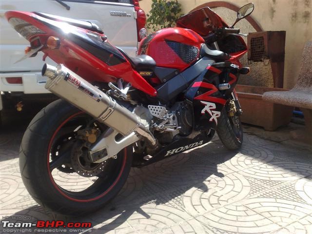

Here is a short Stomp Grip application narration with pictures. Excuse the picture quality, I always tend to forget having my camera around for this kind of stuff.
Even though I'm very skeptical about hitting the track, I was hoping the stomp grip would assist even through the weekend and bumpy city rides. Yet hafta' have a proper post application experience though as I haven' ridden over a couple of kilometers since then.
My cousin had messed up the grips for his Hayabusa while applying it, and the result was indeed a very bubbly tank looking like it was packed in some flimsy plastic.
Hence, I was very hesitant at first to apply the same (had it tucked away for a few weeks), till I came across the instruction leaflet, and I was almost sure my cousin had not followed the same.
So took the plunge.
The hardware, a bottle of clean water, dish washing detergent, sponge and the stomp grips. Decided on the dish washing detergent as the automobile shampoo stuff does not get rid of surface wax which needs to go for a bubble free application.

Both sides of a dusty tank of a bike just back from a weekend ride. The picture quality doesn't really help in judging just how not so clean the tank was.
