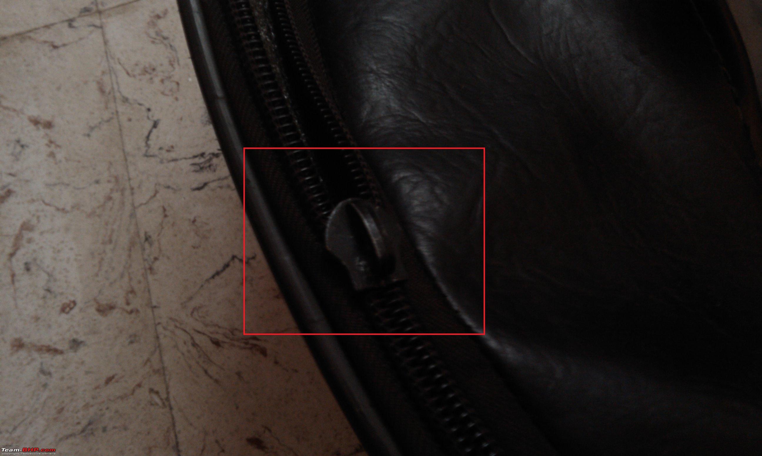

This is the image of the zipper. Notice that the handle has been removed. The locks are usually fixed on the handles! :(
DIY : How to secure a Tata Safari Spare wheel cover from theft-imag0167.jpg
