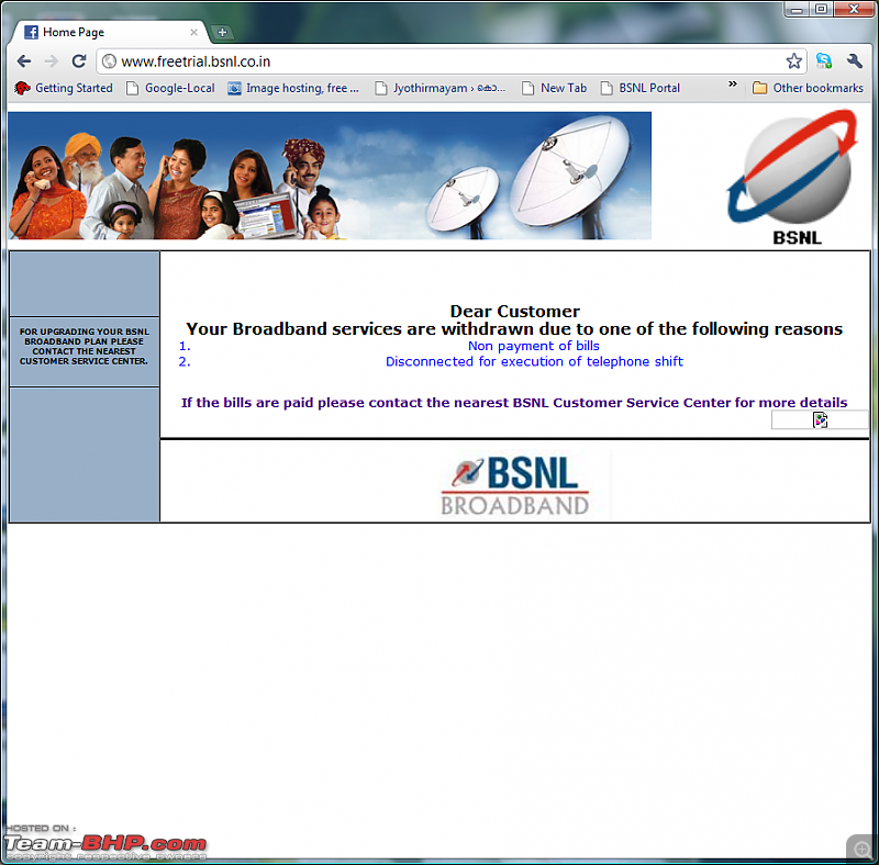

BSNL disabled my internet and phone saying non-payment of bills.
Last month, they charged little extra (they charged telephone rent which was not in the plan) and I went to BSNL office and got it corrected. Then the corrected amount was paid.
This month's bill now comes with that extra amount which I didn't pay last month, and today morning while accessing internet, I get this:
How annoying!!
Now accessing net through my backup connection (Airtel edge) which works perfectly at the moment - very surprising
