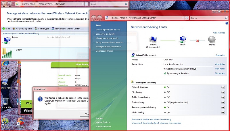

Well..due to some reasons i had to re-install whole OS with recovery dvd after formatting "C" drive.So obviously my laptop's internet settings are gone and i am back to square one.
I have tried everything i can in the last few days but no luck so far.
My BSNL supplied ADSL modem works fine and right now i am using wired connection through this modem only.
When i use linksys software cd and follow the instructions,i dont go beyond 3rd picture (capture1).
I dont remember how i did all this with Tanveer's help.Need again urgent help ASAP.

Doc, when you connect your laptop to the BSNL modem, do you "dial in" from your PC to connect to the internet, or do you just switch on modem and you are "online"?

Your first pic shows "Access: Local only"! This should mean you have told the router not to connect to the Internet.
Unless you are trying to connect on-demand ONLY, Internet access should be achieved by simply setting the Gateway setting of the computer (under IP settings) to the IP address of the Linksys box, usually "192.168.0.1" or "192.168.1.1".
Are you able to see the admin page of the router in the browser (not via the program that runs off the CD)?

derAlte, the computer connects to router, but router is not connecting to ADSL modem

Default
Oops, I thought they were the same box!
The wireless router should be now transparent in the whole scheme, i.e. it should just be a router / access point sending packets back and forth, and not bother about who is sending packets where and whether / which packets are bound for Internet.
* Set DHCP ON in the ADSL box
* Reset the Linksys box and switch off any DHCP on it
* Point all computers to the ADSL box as DHCP server and the Gateway ("192.168.0.1" or "192.168.1.1")
* Implement WEP on the Linksys box for security
I have a similar setup at home: A Huawei ADSL box, connected to a 3Com LAN switch (for the wired LAN connections), and then to a D-Link Wireless router. I connect via wired LAN or WiFi.

Have you hardreset the Wireless router? 2 things I can think of:
1. If authentication is via ppoe thingy, Check if the broadband user /password is saved correctly on the router.
2. If BSNL allows connection only from a particular MAC address, you will have to "copy" the MAC address of your PC/laptop network card to the wireless router.
Your wireless router config screen should have the option for setting up both the above things.

If your modem gives out 192.168.1.x, and if your router is a Linksys (which is also 192.168.1.x) then there may be a problem in routing. Have one of them changed to, say, 192.168.123.x, and that should work. Better still, enable bridge mode in the modem, and let the router do the routing. (The first scenario is what we call as double NATing).
