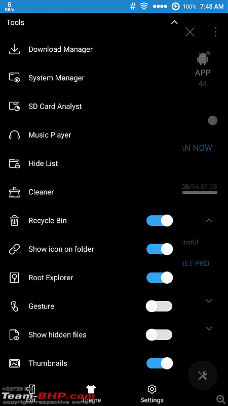

Check point 2, he has given how to do it
You can do this only if you have attained superuser permissions by following the steps numbered 1-19. Open Root Explorer or any other file manager that can handle root permissions and go to the folder /etc, a file named install-recovery.sh should be present there.
I use ES Explorer as a file manager, as soon as you flash clockwork mod and the phone boots, open ES explorer, press the hamburger menu (3 horizontal lines in the top left corner), scroll down and tick yes to root explorer. That gives you the ability to change files in /etc folders.
Android Thread: Phones / Apps / Mods-screenshot_20151223074822.png
Navigate to / then etc folder, there will be a file called install_recovery.sh. Select the file, press 3 dots on the top right and select Rename. Just add .bak to the end of the file and you're done!
the confusion is there also because I have restarted the phone, and I get a message that Link2SD & App2SD have been granted priviliges.
If you don't do this step, the recovery will be reverted back to stock recovery but the ROM will remain the same what you've flashed, you wont lose root access. Its just that flashing another ROM or Zip file will require you to do all the steps mentioned above to install CWM recovery.
This issue is present in all phones. I usually flash a custom ROM with the script for installing stock recovery disabled as soon as the phone boots into recovery so that I don't have to do the step you mentioned.
Hope this helped!
