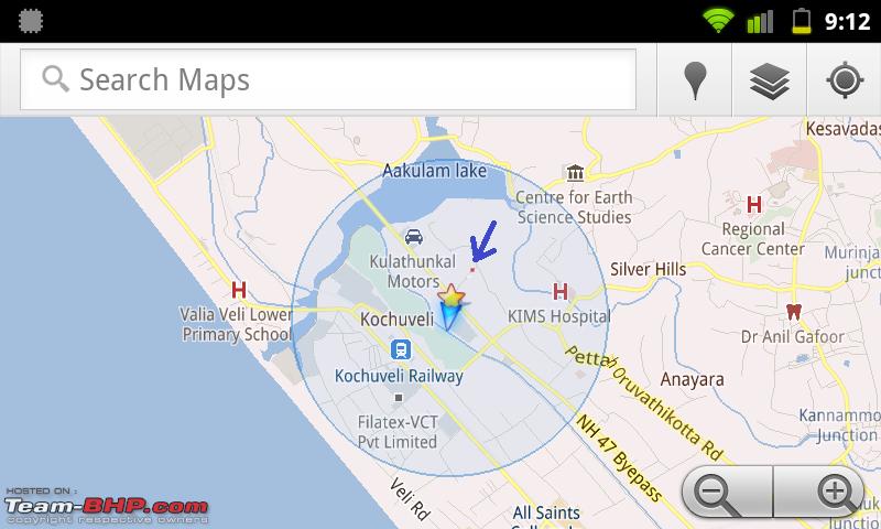

I beg to disagree on the A-GPS part.
A-GPS is Assisted GPS which means, the phone takes help of certain servers over the internet to help the phone to do the initial calculations which are complex, and which will help the phone to determine where exactly is its position with the GPS signals & cell info it received. Having A-GPS does not mean that the phone can determine the position with GPS accuracy, without having GPS signal reception.
The data transfer over internet is just needed in the very beginning when device tries to achieve a lock, and once the device achieves a lock, the device is self capable of updating the position change with GPS signals in that session as well as in the subsequent sessions which may follow soon after it received a lock. This is why some people say that the device achieved a gps lock even without data - they might have tested it soon after experiencing an actual gps lock with data turned on. Turn off mobile data and wifi overnight, and try to achieve a gps lock next day or so, without ever turning on mobile data or wi-fi and you will see.
GPS Signals are a must to get a GPS lock, even with A-GPS.
GPS signals come from GPS satellites and it doesn't matter where you are standing - in ground, or on the top of a 100 floor building - just a good view of the sky is enough. Yes, it will be advantageous in some cases when you are sitting near a window in a top floor, because there are less obstructions of the sky because of lack of trees outside.
When phone doesn't receive GPS signals or when the phone's GPS is turned off, the location is shown with the help of cell tower info, and this location lock is not a 'gps lock'.
The picture below shows the relative size differences in the 'location circle' with cell tower info and a gps lock. The blue circle is the approximate location determined from a cell tower info and the smaller red dot (I marked it) is usually the radius of a gps lock. It can even be smaller depending on how many gps satellites are visible to your device.

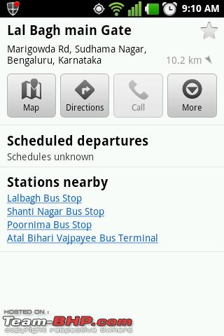

Actually, it doesn't show all those options in mine..
1. Open the Maps app then click the menu button > Labs> select Precache Map Area
2. Go back and click Cache Settings > select Prefetch on Mobile.
3. Go back to map and long press the desire portion so balloon pops up then click that > sign on that balloon
4. Click more and you have see this option window and press Precache Map Area to save it.
A maximum of 10 Precahed Map area can be stored.
