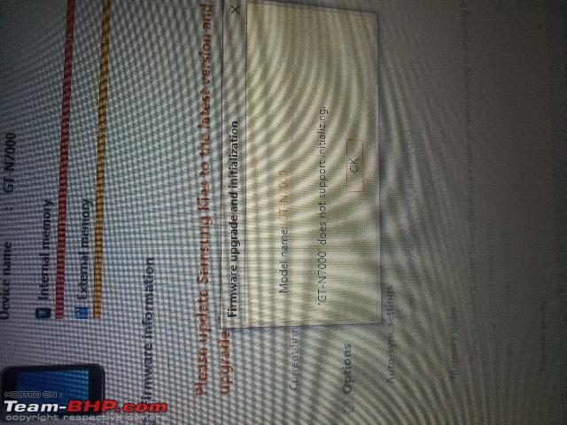

Guys this is the error I am getting. Plz help.

Originally Posted by KSM-Vtec View Post
Attachment 966675

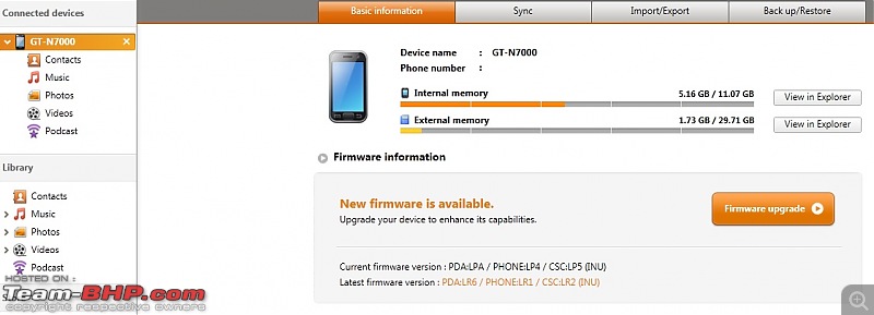

You must have selected Tools-> Firmware Upgrade and Initialization to get this popup window.
To upgrade over Kies, you can just click on the orange "Firmware Upgrade" button that appears on the main screen on the right once Kies detects the Note connected to the PC. I've attached a relevant screenshot for reference.
Android Thread: Phones / Apps / Mods-firmware-upgrade-button.jpg
The problem is that I am not getting that option
Have you updated Kies yet? If not then you need to update the software itself, then you will get that option. Happened in my case when i had to install 4.0.3.
Why arent you trying to flash the new firmware via pcODIN? That is one hassle free method.
I did the kies update during the 4.0.3 and now its the latest version.
I don't really know how the pcodin method works...plz help
