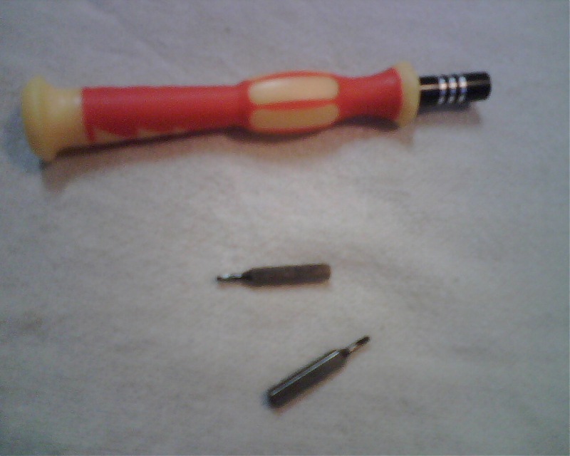

Essential Tools - T6 Screwdriver (Rs 250 for the whole kit)

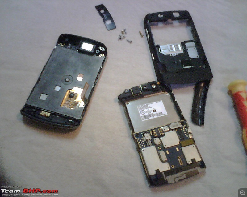

Taken Apart!

There is one thing here which no tutorial mentions. The Screen+Digitizer is glued on to a metal plate which actually keeps the screen from falling off. Now, cnn.cn does not give the metal plate. So, I had to rip that from the old screen.
That led to another issue...there is a thin, double-sided glue paper. Seems like some special kind of sheet. cnn.cn was supposed to provide it, but didnt. So...good ol' Super Glue was used!
