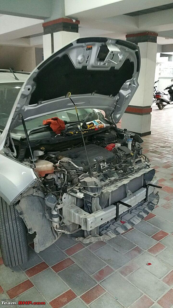

Welding the bracket might weaken the tie member,always best to bolt in the brackets.
-I bought the brackets which are used to fix the aftermarket front crash guard.
-Opened the front bumper-bolted the bracket around the tie member.
-Made a detachable wiring harness and hooked everything together.
Let me check if I have any pictures from my installation

Pics would help a lot.
Am more intrigued to know where you have installed the switch as i didnt find any blank / dummy switches in the ecosport.
Desmosedici is offline   (1) Thanks Reply With Quote

Found two pictures,will add more later.
I installed the switch on the removable pad below the steering coloumn.
Also added a philips cut out to remove load off the switch.

Many thanks for the pics. The clamps look neat. But do the lights vibrate since i see a big overhang plus the lights are very heavy. If it's not much of a trouble, can you please post a front pic of the car with the lights.
