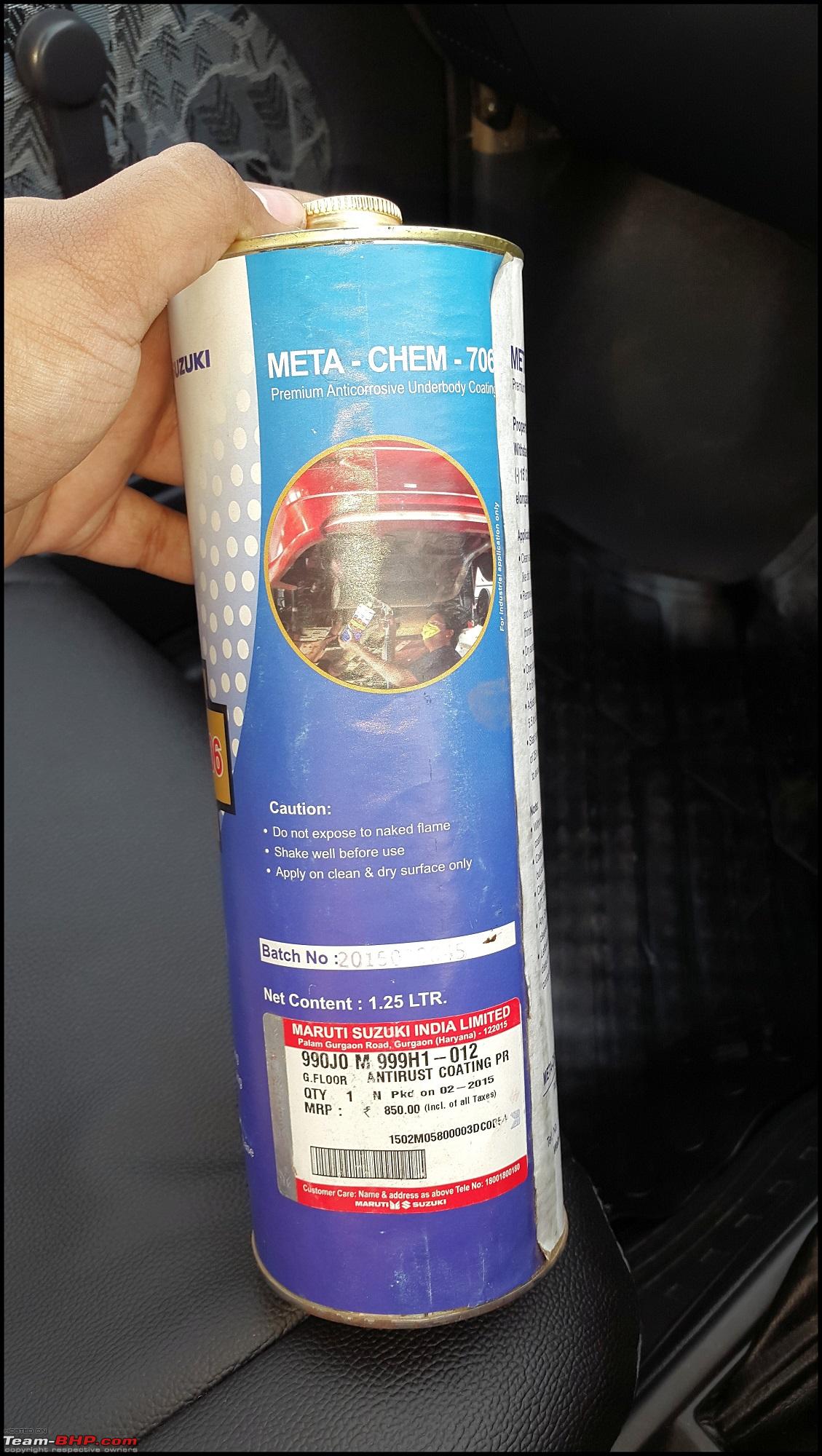

Insulation Type 4- Rubberized underbody polymer based coating. Unlike a lot of products which claim sound deadening properties, this one truly works in that direction, and the sounds coming from the wheel area like tyre noise, pebbles etc are completely eliminated.
Process of application-
1. Initial washing of underbody
2. Sanding and priming of surface rusts
3. Degreasing of underbody
4. Drying
5. Application of underbody coating
The car is then left for about 2 hours on the lift to dry. The entire process takes about 7 hours to complete.

4. Insulation Type 4= Rs. 800(polymer coating) + Rs. 300( washing charges) + Rs. 400(labour)+ Rs. 300(silencer coating)=Rs. 1,800
