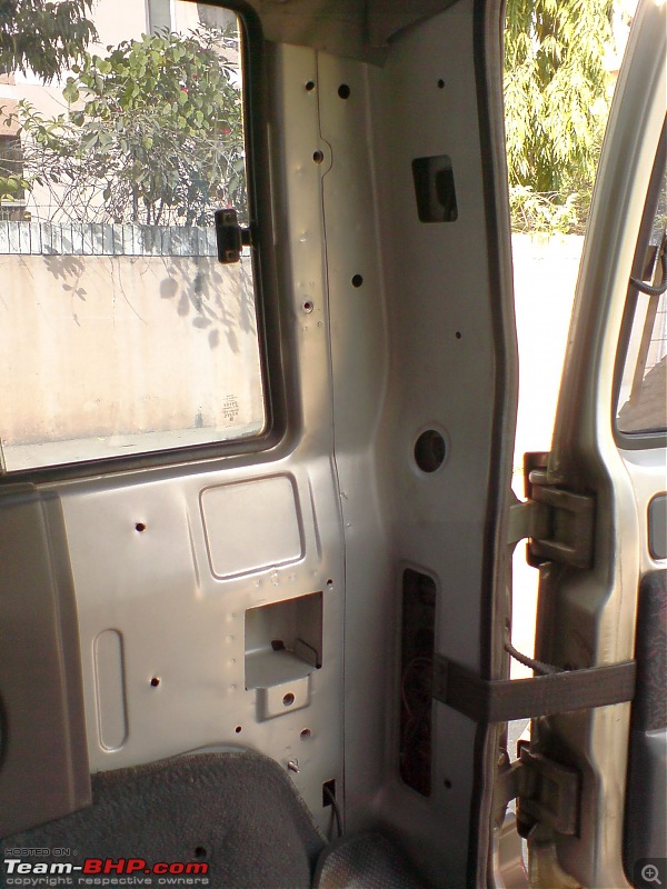

Stock location of rear-speakers :
Truckin'.. A journey of 7 years, 5 months & 78300 km with the Sumo Victa GX Turbo-stock.jpg
The speakers in their stock location are at a double dis-advantage. Apart from being partly hidden behind the jump seats, these speakers are also 'hidden' from the front half of the cabin. The middle seat acts like a barrier for the output of the rear speakers.
