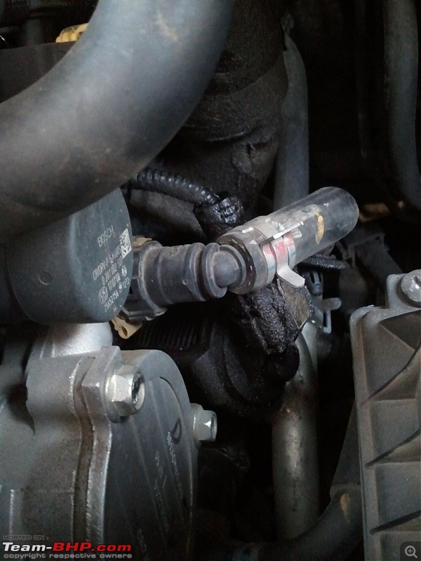

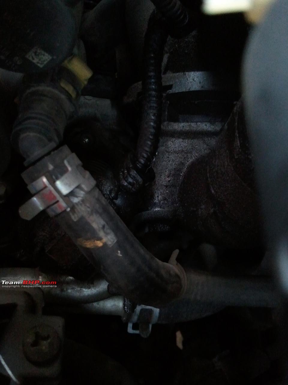

About a month back the SVC light and Fuel filter light lit up on the dashboard. I knew it was the battery (Car is almost 4yrs old and done 50K). Got a new battery and kept delaying the visit to the service center to get the error codes cleared. Everytime the SVC light did not go off before cranking the engine. Drove for about 1000kms this way. Now the SVC light goes off normally like before. I did not have to visit the service center to get the error codes cleared. Strange!!!!

Guys,
Need some help here.
Being Sunday today, was doing a normal cursory check of my car engine bay today and noticed this oil leak (in the images below).
Would be taking the car to MASS next Saturday. The car was servived at 40K and is now at 41.5K and I would be driving approx 250 Kms before Saturday. Hope that is ok too.
From the images, it looks like it might have been there post service. Dont know how I missed the same till now
Any pointers on what can be the issue.
f1fan
This is the area (marked in red) in the engine bay where I noticed this link
Swift Diesel, Saga continues. The DIESEL experience! Part II 72k kms Update Page 182. Now SOLD!-201107031.jpg
These are all shots of the leak.
Swift Diesel, Saga continues. The DIESEL experience! Part II 72k kms Update Page 182. Now SOLD!-201107032.jpg
Swift Diesel, Saga continues. The DIESEL experience! Part II 72k kms Update Page 182. Now SOLD!-201107033.jpg
Swift Diesel, Saga continues. The DIESEL experience! Part II 72k kms Update Page 182. Now SOLD!-201107034.jpg
Swift Diesel, Saga continues. The DIESEL experience! Part II 72k kms Update Page 182. Now SOLD!-201107035.jpg
Swift Diesel, Saga continues. The DIESEL experience! Part II 72k kms Update Page 182. Now SOLD!-201107036.jpg
Swift Diesel, Saga continues. The DIESEL experience! Part II 72k kms Update Page 182. Now SOLD!-201107037.jpg
The oil level looks ok. Hence I feel that the leak is not that bad (hopefully)
Swift Diesel, Saga continues. The DIESEL experience! Part II 72k kms Update Page 182. Now SOLD!-201107038.jpg

Not good, please get it checked. Is it coolant plumbing.
Oil seems to have fallen from valve cover? Am not sure, i will have to check my cars bay to have a better idea. Too much of peeping under DwArF bonnet has taken its toll
Couldn't wait till the weekend, hence took half a day off from work and took the car today morning to MASS. They said that the culprit were some loose clips ( You can see one of them in the center of the third snap completely covered in oil) near the cables and were replaced/fixed and the whole area was cleaned and the car was given back to me.
Hope it was really something that silly. Will keep you all posted.
