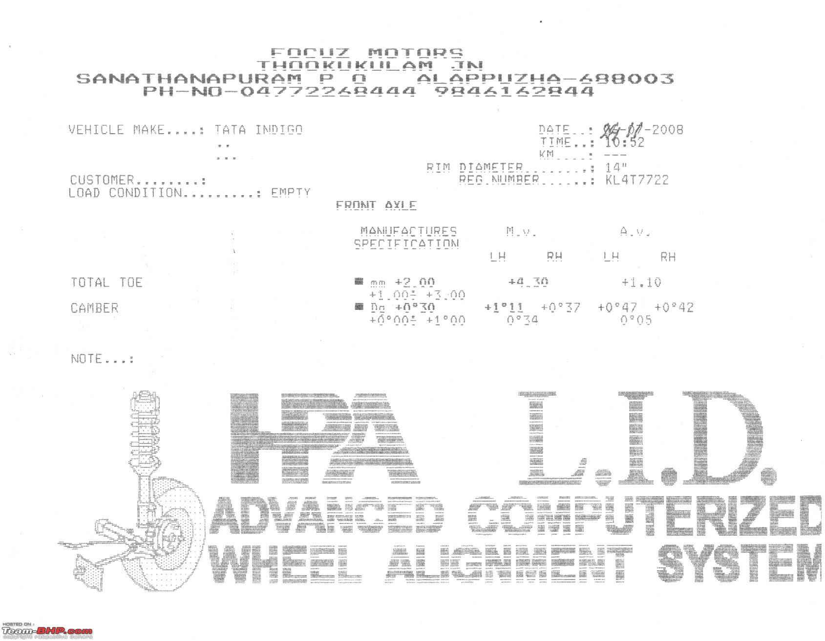

The wheel alignment report:
There was some noise suspected to be from the suspension and the left front tyre showed a little more outside wear than the right. The noise was cured by the caliper shim. Wheel alignment was out and corrected as per the service staff.
No shock absorber or brake pad changes so far. The battery also is fine, so far. AC has not been touched so far and the cooling is excellent.

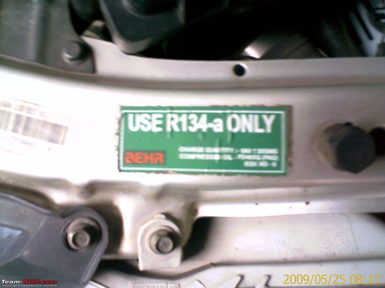

Hi,
There was a discussion about the AC compressor volumes in the ACs available in the Indica, its cosuins and variants.
The different varieties etc were mentioned in the following message:
Yahoo! Groups
greenhorn discovered that his 2007 DLG had a Subros compressor with 660+/-20gms. He wanted me to check in my Marina.
This is what I found:
Sorry for the image quality. It is from a HTC phone. This is what it says:
BEHR - Use R 134a only
Charge quantity: 660 +/- 20 gms
Compressor oil: FD46XG (PAG) Equivalent no. 8
